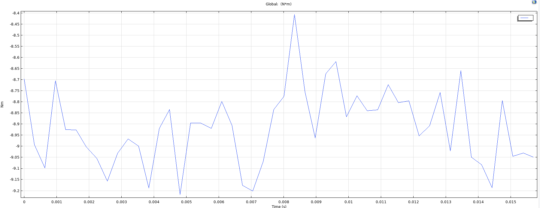

I have been trying to narrow down the issue. I figure that it must be an issue with the force calculation that I am using to compute the rotor torque. The computed results of the rotor torque seem to be pretty unstable. And for the topology of the machine, the large ripple torque that I am seeing doesnt pass a sanity test. I also attached a plot of the rotor torque results.

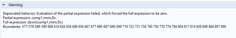

I have read some blogs/tutorials online and understand the sensitiivity/limitations of the maxwell stress tensor to non-linear reigons, so ive tried to ensure I am computing the torque only on air reigon around the rotor. I can see that I am getting a warning message when computing the torque. So far, I have tried to research this "deprecated behavior" message on the forum, but havent found anything yet. Maybe this is a hint :)

Kristian Rye Jensen COMSOL Employee
Posted: 2 years ago 12 avr. 2022, 06:41 UTC−4
Updated: 2 years ago 12 avr. 2022, 06:44 UTC−4
Hi Aaron,
We'd be happy to help sort this out.
As a first step can you send the version of our tutorial in which you have implemented the CoE check to support? You can create a case through: Create a support case
The support is available through your university license.
We can then easier find out what the issue might be and after analyzing that, we'll be better equipped to have a closer look at your model, if needed.
Thanks in advance.
Kristian Rye Jensen
COMSOL DK
Hi Aaron, We'd be happy to help sort this out. As a first step can you send the version of our tutorial in which you have implemented the CoE check to support? You can create a case through: [Create a support case](http://www.comsol.com/support/case) The support is available through your university license. We can then easier find out what the issue might be and after analyzing that, we'll be better equipped to have a closer look at your model, if needed. Thanks in advance. Best regards,
