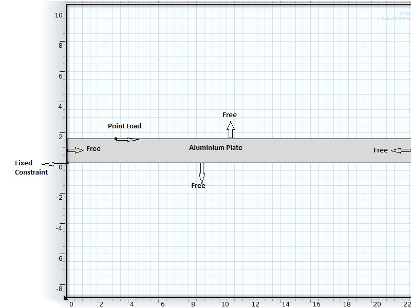

Hi Rohan,
I went through the paper that you listed in detail and then tried modeling it exactly according to the
specifications in the paper. The metal i have taken is Aluminium with specs that of the paper.
E=70GPa, den=2.7gm/cm^3, v=0.33, thickness=1.59mm and applied force 3.2mm from the y axis.
I've used Structural Mechanics as the Physics and time dependent study.
A point load is used to give the point force as F*sin(wt)*(sin(wt/10))^2 *(t<10*pi/w).
A fixed constraint point as a BC to the origin. The remaining geometry i have used free boundary condition.
I ran this for 100kHz frequency.

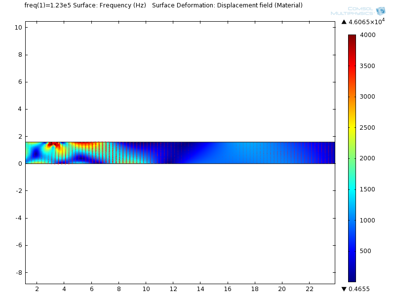

My question is it possible to give a frequency sweep in a time dependent study?
If no, is how can u simulate the graphs for the x component of velocity and y component of velocity as a function of frequency?
Ive not quite got the simulations results that 100kHz should be showing compared to the what the paper shows.
Ive attached the model that ive created in 4.2.
Also attached is the pic of the geometry that i have created.
I would be very helpful if you could upload the model that u created.
Thanks a lot for your time and effort.
Regards
Glenston

Hi Ivar,
This is very elementary but it still is bothering me.
I used a transient physics and time dependent study.
I gave a sine pulse as the input of the form sin(2*pi*1000000[Hz]*t)*(t<=0.000001).
This works fine for me.
Now i want to use another physics which is not transient so therefore im in the frequency domain right?
My first question is how can i give a pulse as an input ?
In the transient case t was my variable ie time, now i dont know how i can make it work?
By giving the same input as above i dont get the same result as in the transient case.
My second question is a more general question could seem very elementary but have to ask.
If i use frequency domain as a study with giving different frequencies in the frequency sweep.
Are these frequency values going to be used as the frequency of the sine excitation at the application of the excitation with user defined amplitude? Or are the results checked for the steady state response to the frequency values .
I don know if ive made it completely clear.
I'm totally confused.
Any kind of reply will help me a lot !
Thanks a lot for your time and effort!!
Regards
Glenston

you are right that first of all you cannot give a time pulse in harmonic sweep solver, it's a constant driving sinus excitation of a given frequency and of a to be defined amplitude and phase (the latter in option if required)
some physics do not have the time derived equation written up, these cannot be solved in "time". One way to better understand what is happening, is to look at the equations COMSOL uses when you switch the different solver, set up a simple physics model and add a stationary, time and frequency harmonic solver, then look at the physics equation while you switch the solver tab, in stationary there is no d/dt^2 present (we are in a quasi static equation mode, with time dependent they appear, and in harmonic they are replaced by the "omega^2" (it's similar to the Fourier like "s" or "z" functions in data analysis)
Now if you mix some ACDC and mechanical physics you might have a time dependent for one and none for the other, the last version of COMSOL have some new frequency - transient and frequency stationary solver set up, these evaluate a period (no pulse variation) in temporal mode and then apply the rms values to the time decay or transient analysis. Mostly ACDC EM waves and physics are "instantaneous" w.r.t. mechanical vibrations frequencies, or thermal diffusion, (not always fully true in the MEMS dimensions !) so as they have completely different time scales, the ACDC effect is a mean RMS response applied to the slower mechanics or HT.
But one can always imagine a case where you do not find (yet) the full combination desired in the Comsol solvers, in these cases one must decide for the closes, and apply some "good engineering practice" to your results
