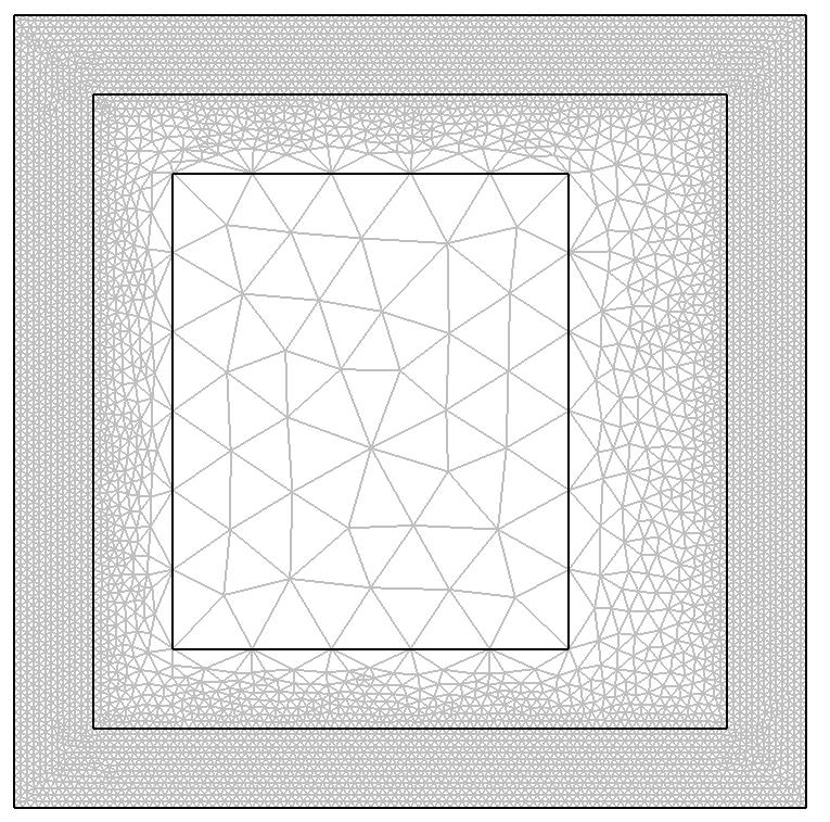

   <description>Hi, I solved my &amp;quot;funny indexing puzzle&amp;quot; :)&lt;br /&gt;&#13;
&lt;br /&gt;&#13;
The functions below might not work for all geometry and might be slow.&lt;br /&gt;&#13;
However, they do the job for me and you may modify the functions for your own needs.&lt;br /&gt;&#13;
&lt;br /&gt;&#13;
- Save the attached functions and add them to your matlab path (Matlab menu: File=&amp;gt;Set Path...)&lt;br /&gt;&#13;
- Export your fem structure to the Matlab workspace as &amp;quot;fem&amp;quot;.&lt;br /&gt;&#13;
- Run following command: &lt;br /&gt;&#13;
  fem=remove_internal_boundaries(fem)&lt;br /&gt;&#13;
- Import the new fem structure &amp;quot;fem&amp;quot; back to the Comsol interface.&lt;br /&gt;&#13;
&lt;br /&gt;&#13;
Good luck!&lt;br /&gt;&#13;

   <description>Hi,&lt;br /&gt;&#13;
I want to generate a mesh with variable mesh element size for semiconductor simulations. &lt;br /&gt;&#13;
My current approach is:&lt;br /&gt;&#13;
- Define a &amp;quot;mesh-size expression&amp;quot; mesh_size(x,y) in the scalar expressions.&lt;br /&gt;&#13;
- Copy the fem structure &amp;quot;fem&amp;quot; to a dummy fem structure &amp;quot;dummy_fem&amp;quot; &lt;br /&gt;&#13;
- Initialize the fem structure and calculate contour lines of the expression mesh_size(x,y).&lt;br /&gt;&#13;
- Take the contour lines as subdomain boundaries.&lt;br /&gt;&#13;
- Mesh the subdomains with different mesh sizes, according to the &amp;quot;countour-height&amp;quot;.&lt;br /&gt;&#13;
- Remove the internal boundaries.&lt;br /&gt;&#13;
- Transfer the new mesh of &amp;quot;dummy_fem&amp;quot; to &amp;quot;fem&amp;quot;, including all boundary conditions ect. &lt;br /&gt;&#13;
&lt;br /&gt;&#13;
If i do not remove the boundaries i would have to specify the physics for a lot of regions&lt;br /&gt;&#13;
where the physics is the same. &lt;br /&gt;&#13;
&lt;br /&gt;&#13;
Another approach was to start with a coarse triangle mesh and refine&lt;br /&gt;&#13;
the triangles if triangle-size is smaller than mesh_size(x,y). This&lt;br /&gt;&#13;
takes too much time and the mesh is too fine at some locations. &lt;br /&gt;&#13;
&lt;br /&gt;&#13;
Is there a way to import a mesh without meshenrich?&lt;br /&gt;&#13;
&lt;br /&gt;&#13;
If I find another way to get my wanted mesh point coordinates (and use the delaunay triangulation &lt;br /&gt;&#13;
function...) I would get the same problem with the mesh import. &lt;br /&gt;&#13;
&lt;br /&gt;&#13;
So the main question is: &amp;quot;How to import a mesh for a already existing geometry?&amp;quot; </description>

   <description>Hi Stefan again,&lt;br /&gt;&#13;
the &amp;quot;meshenrich&amp;quot; function creates also a new geometry decomposition based just only on mesh data. This geometry may be different from the original one (that one you created after removing internal boundaries). The approach I suggested you can be useful but you need to redefine all domain and boundary conditions. &lt;br /&gt;&#13;
Please tell me why you need to delete interior boundaries from your application? Is there some specific reason? &lt;br /&gt;&#13;
&lt;br /&gt;&#13;
Pasquale&lt;br /&gt;&#13;

   <description>Hi Pasquale,&lt;br /&gt;&#13;
&lt;br /&gt;&#13;
thank you for your answer! I got on the same path and below is some stuff i tried. &lt;br /&gt;&#13;
&lt;br /&gt;&#13;
It is possible to extract the triangle information and create a new mesh without internal&lt;br /&gt;&#13;
sobdomain boundaries. So far so good. &lt;br /&gt;&#13;
&lt;br /&gt;&#13;
It is also possible to create a new geometry from this new mesh and import it together&lt;br /&gt;&#13;
with the new mesh back to the Comsol interface.&lt;br /&gt;&#13;
&lt;br /&gt;&#13;
But if I try to fit the new mesh to my own geometry (old geometry after removing&lt;br /&gt;&#13;
internal boundaries) I get following error:&lt;br /&gt;&#13;
&lt;br /&gt;&#13;
&amp;quot;Geometry object and mesh object are not compatible.&amp;quot;&lt;br /&gt;&#13;
&lt;br /&gt;&#13;
I saw some small differences (in the order of 1e-20) in the coordinates of the edge&lt;br /&gt;&#13;
points of my new mesh and the edge point coordinatets of the geometry. Could&lt;br /&gt;&#13;
that be the reason? I tried to rescale the mesh coordinates, but the scaled mesh did not fit, too.  &lt;br /&gt;&#13;
&lt;br /&gt;&#13;
Any idea how I have to further modify the mesh or the existing geometry?&lt;br /&gt;&#13;
(I do not want to reset my application modes.)&lt;br /&gt;&#13;
&lt;br /&gt;&#13;
-------------------------------------------------------------------------&lt;br /&gt;&#13;
%- read mesh data from fem structure&lt;br /&gt;&#13;
ele=get(fem.mesh,'el');&lt;br /&gt;&#13;
p=get(fem.mesh,'p');&lt;br /&gt;&#13;
&lt;br /&gt;&#13;
%-get triangles...&lt;br /&gt;&#13;
tria=ele{3}.elem;&lt;br /&gt;&#13;
&lt;br /&gt;&#13;
%- create new structure...&lt;br /&gt;&#13;
elestr{1}=struct('type','tri','elem',tria);&lt;br /&gt;&#13;
&lt;br /&gt;&#13;
%- create new mesh object...&lt;br /&gt;&#13;
fem.mesh=femmesh(p,elestr);&lt;br /&gt;&#13;
&lt;br /&gt;&#13;
%- update comsol data&lt;br /&gt;&#13;
fem.mesh=meshenrich(fem);&lt;br /&gt;&#13;
&lt;br /&gt;&#13;
&lt;br /&gt;&#13;
%generate geometry from mesh (import would work with this new geometry)&lt;br /&gt;&#13;
%fem=mesh2geom(fem);&lt;br /&gt;&#13;
&lt;br /&gt;&#13;
%delete interior boundaries of geometry (import does not work with resulting geometry)&lt;br /&gt;&#13;
fem.geom=geomdel(fem.geom);&lt;br /&gt;&#13;
&lt;br /&gt;&#13;
%meshplot(fem,'Boundmode','off');&lt;br /&gt;&#13;
%geomplot(fem)&lt;br /&gt;&#13;
&lt;br /&gt;&#13;
%!!!!!! Import of 'fem' results in the error &amp;quot;Geometry object and mesh object are not compatible.&amp;quot; !!!!!!!!&lt;br /&gt;&#13;
&lt;br /&gt;&#13;
-----------------------------------------------------------------------------&lt;br /&gt;&#13;
&lt;br /&gt;&#13;
some further code snippets:&lt;br /&gt;&#13;
&lt;br /&gt;&#13;
%get mesh point coordinates from file&lt;br /&gt;&#13;
%d=importdata('mesh.mphtxt',' ',22);&lt;br /&gt;&#13;
%xy=d.data(1:end-1,:);  %remove last line with NaN&lt;br /&gt;&#13;
&lt;br /&gt;&#13;
%get mesh point coordinates from fem structure&lt;br /&gt;&#13;
xy=get(fem.mesh,'p')';&lt;br /&gt;&#13;
&lt;br /&gt;&#13;
%remove scaling errors&lt;br /&gt;&#13;
%xw =3e-4;     %specify width of geometry&lt;br /&gt;&#13;
%yw =1.5e-4;  %specify height of geometry&lt;br /&gt;&#13;
&lt;br /&gt;&#13;
%max(xy(:,1))-xw %errors before scaling&lt;br /&gt;&#13;
%min(xy(:,2))+yw %&lt;br /&gt;&#13;
&lt;br /&gt;&#13;
%xy(:,1)=xy(:,1)*xw/max(xy(:,1));&lt;br /&gt;&#13;
%xy(:,2)=xy(:,2)*(-yw)/min(xy(:,2));&lt;br /&gt;&#13;
&lt;br /&gt;&#13;
%max(xy(:,1))-xw %errors after scaling = 0&lt;br /&gt;&#13;
&lt;br /&gt;&#13;
%generate delaunay triangle mesh from mesh point coordinates&lt;br /&gt;&#13;
tri = DelaunayTri(xy(:,1),xy(:,2));&lt;br /&gt;&#13;
vertices=tri.Triangulation;&lt;br /&gt;&#13;
coord=tri.X;&lt;br /&gt;&#13;
&lt;br /&gt;&#13;
%transform the matlab mesh to a comsol mesh structure fem.mesh&lt;br /&gt;&#13;
el = cell(1,0);&lt;br /&gt;&#13;
el{1} = struct('type','tri','elem',vertices');&lt;br /&gt;&#13;
fem.mesh = femmesh(coord',el);&lt;br /&gt;&#13;
fem.mesh = meshenrich(fem);&lt;br /&gt;&#13;
&lt;br /&gt;&#13;
%!!!!!! Import results in the same error &amp;quot;Geometry object and mesh object are not compatible.&amp;quot; !!!!!!!&lt;br /&gt;&#13;
&lt;br /&gt;&#13;

   <description>Hi Stefan,&lt;br /&gt;&#13;
I guess that there is no way to solve your question by using comsol gui tools. I thing that you should try via Matlab.&lt;br /&gt;&#13;
Try the procedure below:&lt;br /&gt;&#13;
1. create the live-link with matlab&lt;br /&gt;&#13;
2. export fem data as matlab structure (your variable is saved in the workspace as &amp;quot;fem&amp;quot; by default)&lt;br /&gt;&#13;
3. run the following matlab script:&lt;br /&gt;&#13;
&lt;br /&gt;&#13;
%%%%%%%%%%%%%%&lt;br /&gt;&#13;
%- get element data...&lt;br /&gt;&#13;
&lt;br /&gt;&#13;
&lt;br /&gt;&#13;
&lt;br /&gt;&#13;
mobj=femmesh(node,elestr);&lt;br /&gt;&#13;
&lt;br /&gt;&#13;
mobj=meshenrich(mobj);&lt;br /&gt;&#13;
&lt;br /&gt;&#13;
femNew.mesh=mobj;&lt;br /&gt;&#13;
&lt;br /&gt;&#13;
4. now &amp;quot;femNew&amp;quot; is the updated comsol structure having only mesh data information (as you are looking for)&lt;br /&gt;&#13;
5. import &amp;quot;femNew&amp;quot; in comsol and run your application mode.&lt;br /&gt;&#13;
&lt;br /&gt;&#13;
I hope this can help you.&lt;br /&gt;&#13;
Please let me know if this works well!&lt;br /&gt;&#13;
&lt;br /&gt;&#13;
Good luck&lt;br /&gt;&#13;
&lt;br /&gt;&#13;

   <description>I have three subregions and mesh the subregions with different mesh size&lt;br /&gt;&#13;
(see attached figure).&lt;br /&gt;&#13;
After meshing i want to &amp;quot;remove&amp;quot; the internal boundaries&lt;br /&gt;&#13;
and keep the variable sized mesh.&lt;br /&gt;&#13;
&lt;br /&gt;&#13;
At the end there should be only one subregion but the mesh should &lt;br /&gt;&#13;
stay &amp;quot;the same&amp;quot; as before. &lt;br /&gt;&#13;
&lt;br /&gt;&#13;
How can I convert the internal boundaries to triangle edges&lt;br /&gt;&#13;
of a &amp;quot;combined mesh&amp;quot;?&lt;br /&gt;&#13;
