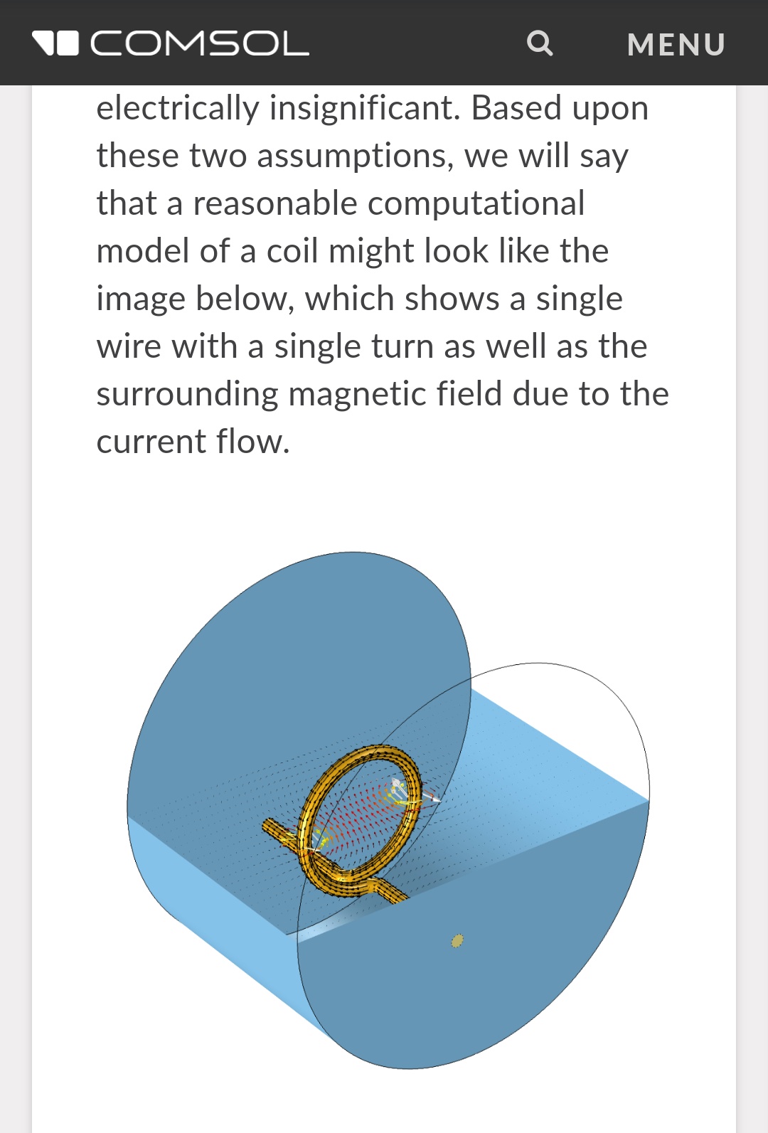

Madam/Sir, I'm new to this software. I've went through the introduction videos posted in the website itself. I went through one of the blog written by Walter Frei which said about designing a single current carrying coil, in COMSOL. I want to start with the similar(and simple) example (attached with this post) to get to know the platform. Is there any step by step instructions as how to achieve the whole modelling and simulation processes?
P.S.- One of the figure is is attached with the discussion post. Please check the same.
