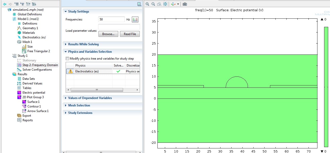

I'm currently studying the electromechanical effects of a water droplet under AC/DC voltages. The water droplet is placed between two rectangular electrodes. I've applied a electric potential to one of the electrodes and grounded the other.
I currently I have no issue simulating DC conditions in electrostatics, however when I simulate AC conditions I encounter a problem. I disable the stationary study and add frequency domain study. Leaving the magnitude in the electric potential, in the study settings I add a frequency of 50Hz. When I compute the simulation there is no electric potential or electric field.
Can someone help. Am I doing this process right or am I missing a step?

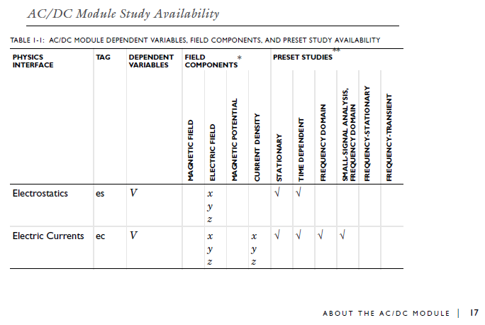

ES is not defined for frequency domain.
Ralf
I would answer yes and no ;) as ES does not allow for current flow, hence no resistance values, and no magnetic fields hence no true L inductance values, only pure capacitances. then the d/dt or omega^1 term can be dropped,
Then as you have C alone the d/dt^2 or omega^2 term can also be dropped. which means that even if frequency domain is not solved for, you can still do it without errors, whithin the hypothesis of ES

I tried running an AC simulation in EC and it worked no problem, however when I disabled frequency domain and ran a stationary study I got a singular matrix error and didn't know how to solve it. So I basically got fed up and created two files. One with ES stationary for DC simulations and one in EC with AC simulations.

I'm just curious to know why ES doesn't offer electrical insulation boundary conditions where as EC does and will it effect results?
I would say that is because there is no current flow in ES (static) so by default it's "isolated everywhere" those are the basic hypothesis of ES.
Indeed air has 0 S/m conductivity in the material library, this is probaby correct (physically) but gives issues for the solver in EC or MEF mode, therefore you need sometimes, to add a little conduction even for "air"
