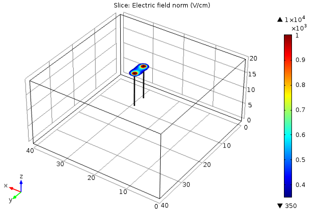

I have a similar problem. I'm trying to calculate the area of a Surface Plot which is in a data range (coloured area in attached image). The plot is an electric field distribution.
How can I solve my problem?
Thanks.
Hi, I have a similar problem. I'm trying to calculate the area of a Surface Plot which is in a data range (coloured area in attached image). The plot is an electric field distribution. How can I solve my problem? Thanks.
