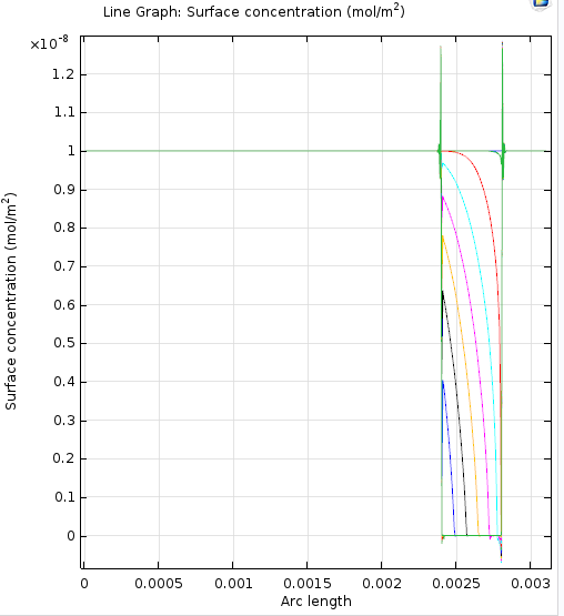

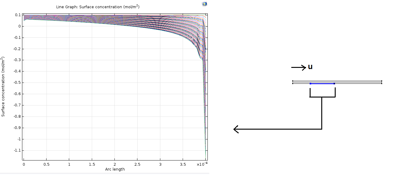

The problem with this model is that the concentration of B on the surface can reach negative concentration. (which is equal to the concentration of C on the surface going over the initial concentration of B). even though i have set a number of maximum available sites on the surface, which is the same number as initial reactant B on this surface.
Is there a way to fix this problem?
i am using the chemistry, laminar flow, transport of diluted species and surface reaction modules for this.
concentrations are in the order of 10^-7. pressure is around 1 atm, fluid velocity is 2.5e-4 m/s.
I have tried different time steps for the solver, the danckwerts flux, ramp up the concentration from the initial start instead of a set concentration but none of these worked.
Only increasing my concentrations by a few orders of magnitude and decreasing my reaction rates to unrealistic values led me to a solution where the concentration of B didn't fall below zero and was limited to 0.

No,it starts at the edge of the reaction surface, but as time increases a greater portion of the surface reaches a negative concentration. I've included a picture of the domain i'm talking about.

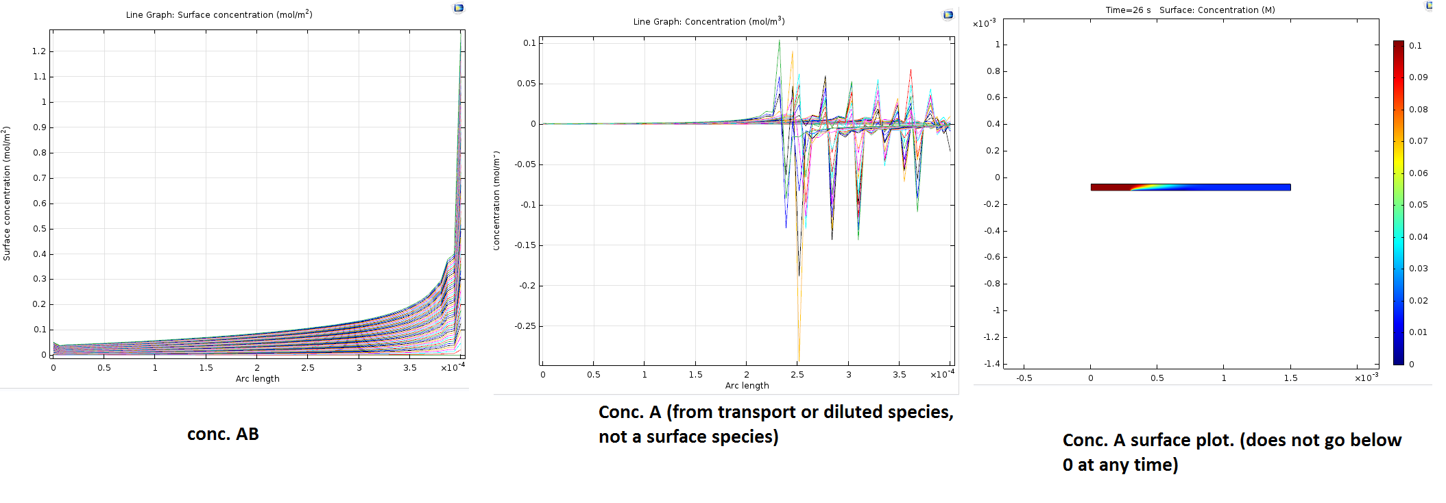

Can you also plot the concentration of A on the surface as well?

here are the plots of concentration AB on the surface. and Concentration A along the surface. (although last one is taken from the transport of diluted species data because A is not a surface species.) i also included the contour plot of the concentration of A inside the domain, which i never see falling below 0.

Sorry man, I am stumped. With your B concentration going negative, you should have a negative reaction rate, which should cause the generation of species A instead of consumption. But your A contour plot looks perfectly normal.

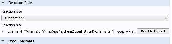

Just put "max(eps^2, R)" where you would put the user defined reaction rate. With R being your actual reaction rate. This should fix the issue.
thanks! i've put the term around my reaction rate term of the species which went negative in concentration. It seems to have fixed the issue!
