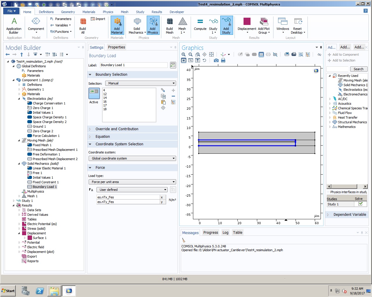

Method of coupling: - Defined a boundary load (selected cantilever boundaries except fixed end) under solid mechanics - Maxwell's stress tensor for X and Y components are defined as follows: - Fx = es.nTx_Fes - Fy = es.nTy_Fes
The screenshot refering to boundary load is attached.
Can anyone please help me? Method of coupling: - Defined a boundary load (selected cantilever boundaries except fixed end) under solid mechanics - Maxwell's stress tensor for X and Y components are defined as follows: - Fx = es.nTx_Fes - Fy = es.nTy_Fes The screenshot refering to boundary load is attached. Thanks
