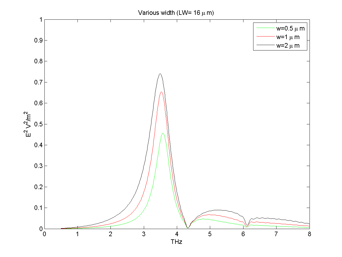

I'm an electronic-engineering student at the University of L'Aquila (Italy), and I'm quite new to COMSOL. To get practice with COMSOL I was told to replicate a simulation done with another simulation program. My goal is to simulate a sort of Terahertz filter, made of a thin layer of Aluminium ad a Silicon substrate. I attached the model I'm working with.
After days of trying, I got stuck because I cannot have the same response (in terms of E^2) as the one i get with the other program, with the same geometry, and same materials. I attached this response too.
The professor who created this simple simulation with the other program told me to excite the filter with a plane wave along the x-axis, and to consider the periodic condition 'to both the directions' . I can't understand what he meant with this last imposition, so I ask the same questions to everyone who may know.
I had tried to set Periodic Condition to the 4 long faces of the substrate, but the program text me an error, so I removed that condition, and that's where I'm stuck.
- How Periodic Condition can be applied to my model?
- The different response is due to wrong materials properties?
- Have I made any error in the physics (emw) branch description of the model?
- There is a way to plot the same expression (E^2) to have better comparison?
