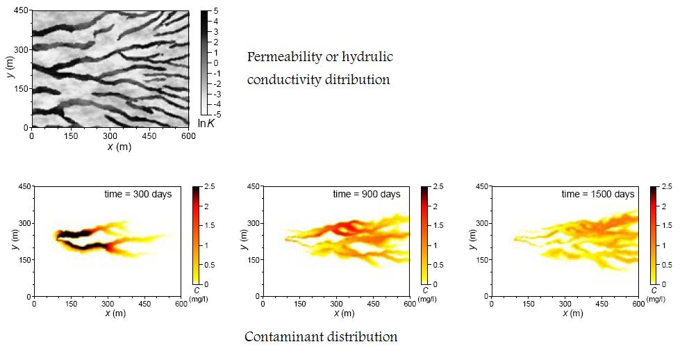

I have a 2D grid (100x50) which each of its grid has a permeability value (such a a 2D map of permeability distribution for a porous medium). I want to put a contaminant a specific point and under some hypothetical conditions (such flow rate, porosity, ....) see its distribution in different times (such as 2 days, 1 month, 3 months,...)
Can anyone help me about it? my main problem is that how I should define a 2D permeability grid in COMSOL!
I attached a file in which I clear my mean.

Please take a look on my data in attachment and see that is is possible I model the contaminant transportation via COMSOL in different times or not! you can see the data easily in MATLAB by imagesc(). The data are hydraulic conductivity.

Up to this time I am sure that COMSOL can handles my problem. My main problem is that COMSOL consider the hydraulic connectivity (HC) constant for all of the grid while I want that each grid have a specific value. Therefore, in other words I do not know that how I should enter the different values for HC!
Also the data are HC and I just scaled them into [-5 5]. Here is the original data.
