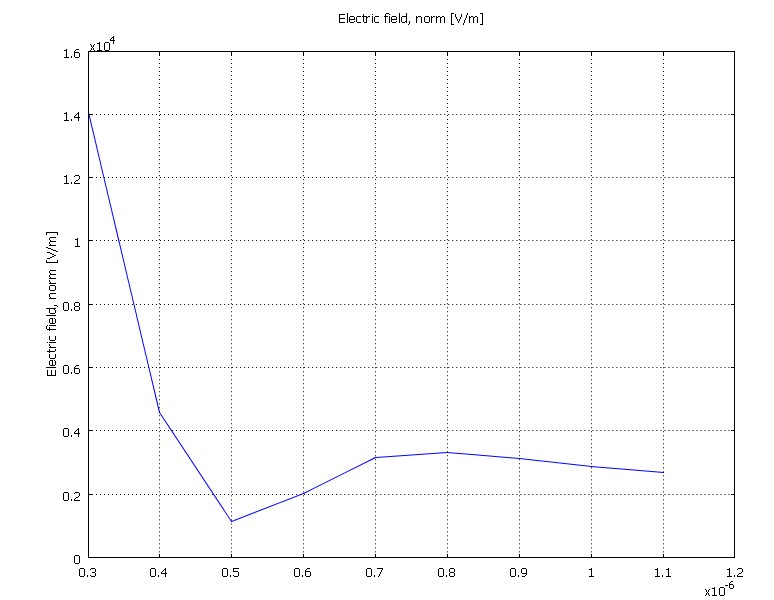

I've got exactly the same problem - I'm trying to model nanostructures and also get the peak for lower wavelengths. I tried doing the calculation without anything in my box and get the same peaks...either we are doing something wrong or there is a bug in Comsol.

I have been playing around with the size of the PMLs as well as using well-defined ports instead of automatic plane wave excitation, and I always get the same initial peak for low wavelengths, with or without object in my "box" (see the attached Strangespectrum.jpg). For the attached model, plotting the near field spectrum at point (0,0) results in another peak at higher wavelengths, which is the one I would expect, I think. But I cannot think of any explanation as to the first peak....

Hi! I have been playing around with the size of the PMLs as well as using well-defined ports instead of automatic plane wave excitation, and I always get the same initial peak for low wavelengths, with or without object in my "box" (see the attached Strangespectrum.jpg). For the attached model, plotting the near field spectrum at point (0,0) results in another peak at higher wavelengths, which is the one I would expect, I think. But I cannot think of any explanation as to the first peak.... Kind regards, Martina
