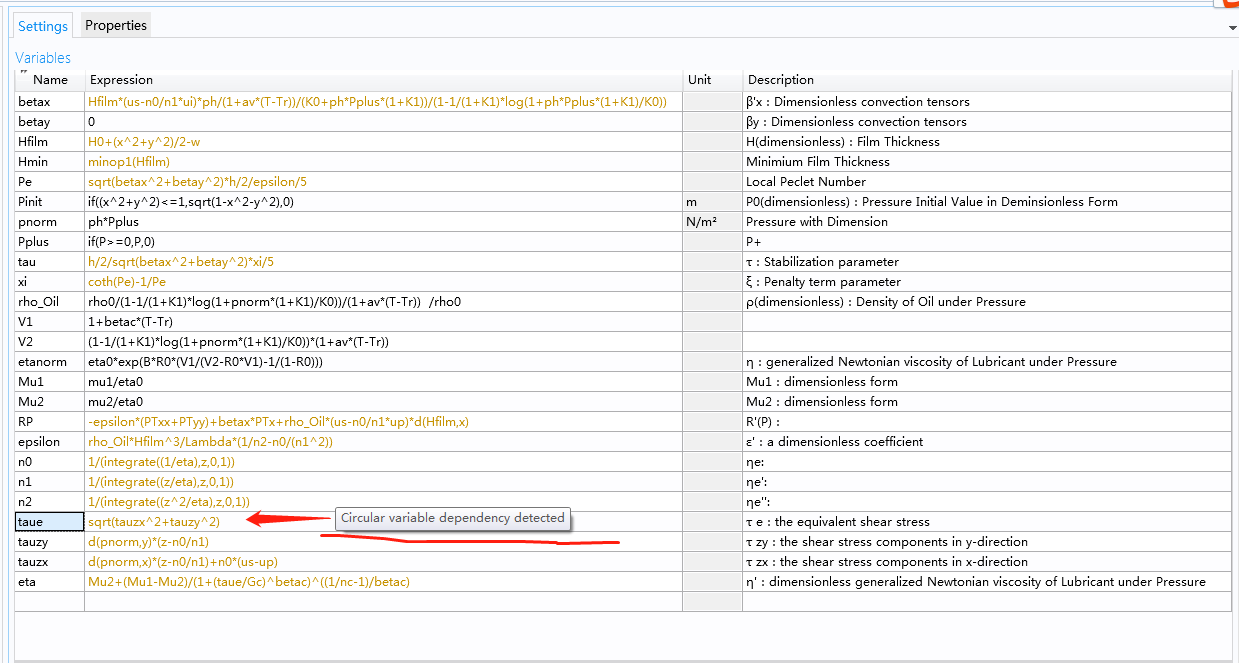

Hi,firstly,I am sorry for my unclear statement and thanks your advice.
So,I show you a screenshot: τe(taue) is detected as a circle variable.
I think there is no mistake in its definition. And I've been reading a paper that says need to give τe an initial value.So do you know that how I can add an initial value to it? Please.......

COMSOL is warning you that you have a circular dependency.
And indeed, tau_e depends on n0 and n1 (through tauzx and tauzy), which in turn depend on eta, itself dependent on tau_e.
There might be other circularities but this one is the most obvious.
If your definitions of tau_e, etc. are correct, this means that you must input this as an equation to solve for, but you can't do it as a series of variables.
