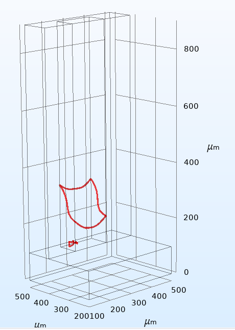

How to find the temperature of meniscus during capillary filling
Posted 20 nov. 2019, 08:12 UTC−5 Fluid & Heat, Heat Transfer, Microfluidics 1 Reply
Hello, I am trying to simulate 3d rectangular capillary filling using Leve set and two-phase flow, but simultaneously heat or (put at T+Tref) the one wall of the capillary, everything including (meniscus position(ls.Vf1), velocity, etc.) I found easily. The problem is, I am not able to calculate/plot the temperature profile along with the meniscus at some instant (look at attached figure). Thanks in advance!
