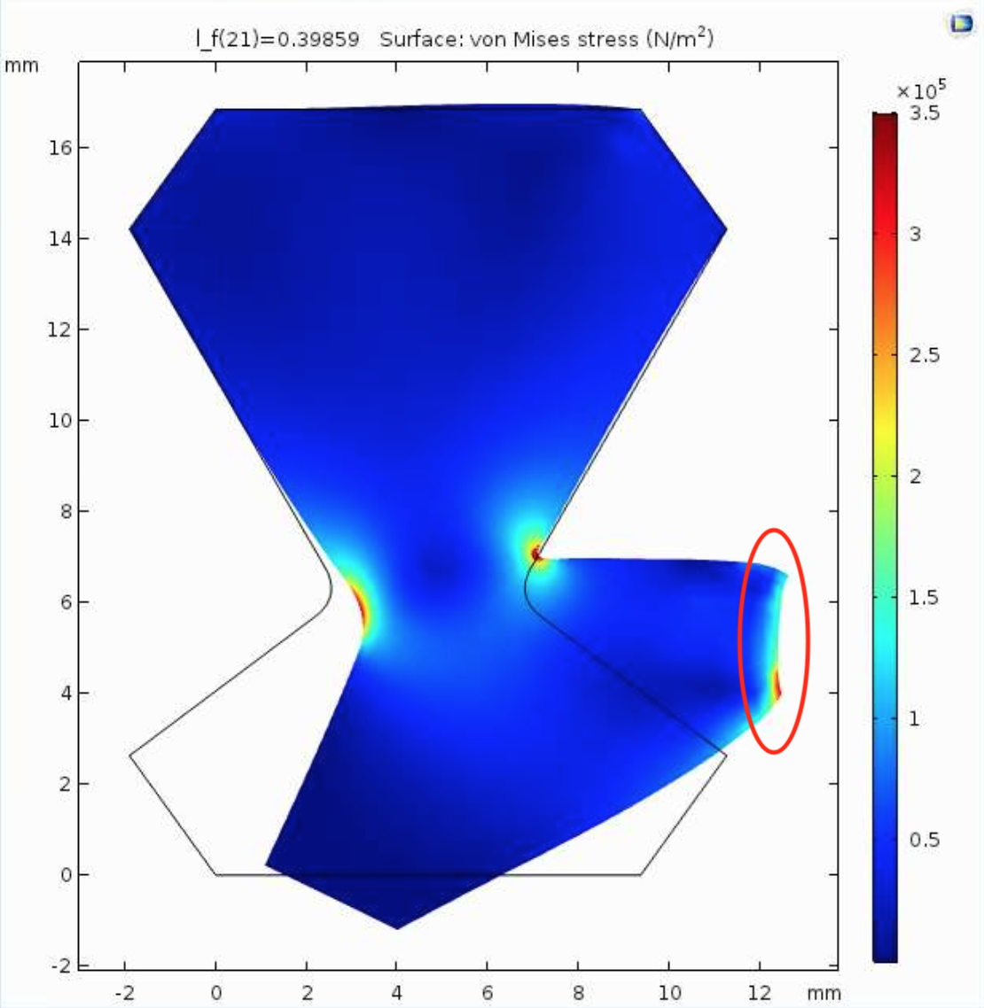

I am attempting to model a flexure hinge subject to bending (see attached picture and model) using the Solid Mechanics module with a stationary study and have run into convergence issues.
For the simulation, I am using an auxiliary sweep with a ramped displacement applied to the bottom right face of the flexure hinge (circled in red on the von_Mises_Flexure_Hinge photo). The issue I am having is the simulation fails to converge around a displacement of 4mm, which corresponds to the deformed shape in the von_Mises_Flexure_Hinge photo. Ideally I would like to be able to model the deformation until their is contact between the two faces on the compression side of the flexure hinge.

Does anyone have any suggestions/ideas as to why the simulation fails consistantly around a 4mm displacement? Does anyone have any suggestions/ideas on how to make the simulation proceed further until the two faces contact each other?
