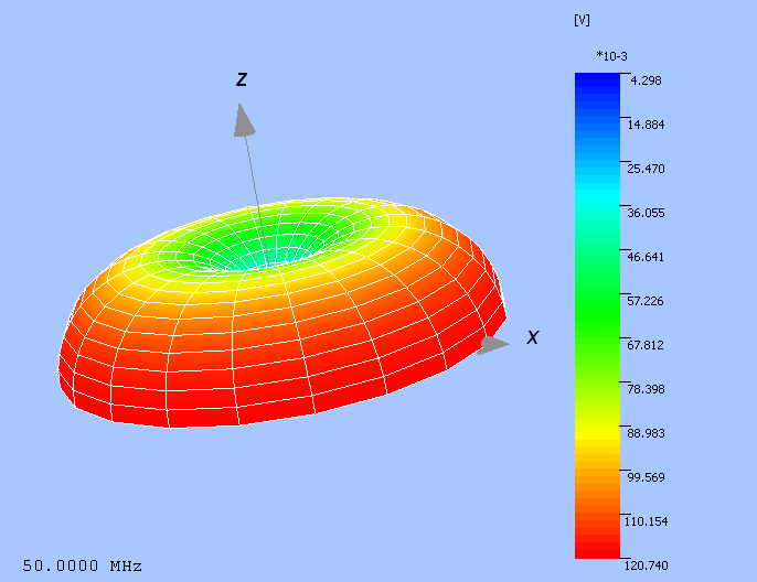

And about the 3D plot. I tried to recalculate results from a other simulation program, see attached picture. I want to compare the simulation of the both programs. And actually it should be same.
@Edgar: You are right my first idea was to set the port vertical between the antenna rod and the ground plane, like in the attached model. But then I get the errors from the solver. Is there anything missing or wrong?
Thanks so far
stefan

I think the port should rather be a horizontal piece that connects the vertical rod at its ground end and the ground plane.
