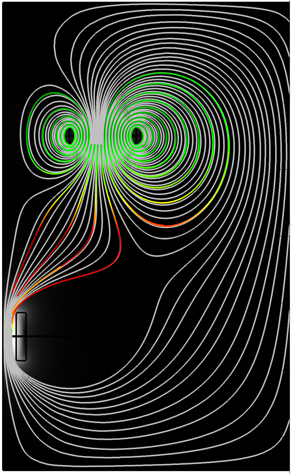

Sorry if I have been slightly unclear. I have attached a image of the same setup using the post-processing particle tracer instead. I've messed around with the colours slighty, the black to white background indicates B-field magnitude, the grey lines are 'streamlines' for the B-field and the coloured tracks are the particle tracing, green indicates high speed, red low. This is the behaviour I am expecting from the CPT module but am not getting; it is not taking the B-field into account. The particles released from the upper surface should roughly follow the field lines - this would be more accurate a statement if the E-field were turned off.
The Lorentz force due to such a large magnetic field should cause the particle to follow the field lines whilst executing a helical orbit. The component of velocity along the field line, as you said, gives no force. The component of velocity perpendicular to the field line results in a force which causes the particle to orbit around the field line. In the image I have attached, the particle tracks are really small helical tracks when one zooms in.

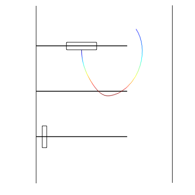

I then cleared the solution, re-ran both studies, and voilà, it worked, see figure attached or the modified model file. (Turns out, "File extension error" is the forum software's way of saying, "You need to activate Firefox's Flash plugin." Obviously...)
