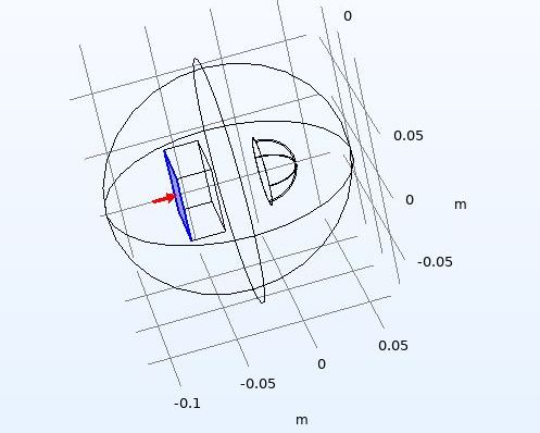

I have created the copper shell, a rectangular port, and a spherical boundary around the shell and port that is filled with air. I'm considering 1 kW power and a 2.45 GHz source initially, just for the proof-of-principle part of the model (an image of the geometry and defined port are attached).

Did you intend that your outer sphere be a perfect electrical conductor? Your microwave source is also rather strange (and too coarsely meshed, among other issues). What kind of microwave source are you trying to represent? Note that if your source is intended to be a waveguide aperture, then there are better ways to specify it (take a look at examples in the Application Library). Anyway, you seem to be trying to explore the heating of a hemispherical shell of copper (or perhaps the air next to the copper?) suspended inside a too-small spherical microwave oven (but with walls that conduct better than the copper??), along with a floating-in-space microwave source (which also seems small, when one considers the RF wavelength at 2.45 GHz). Is all that what you intended to study?
