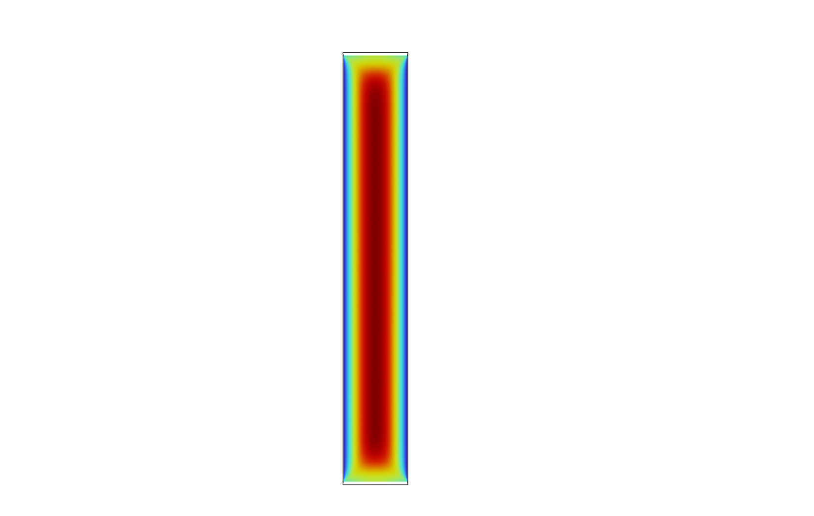

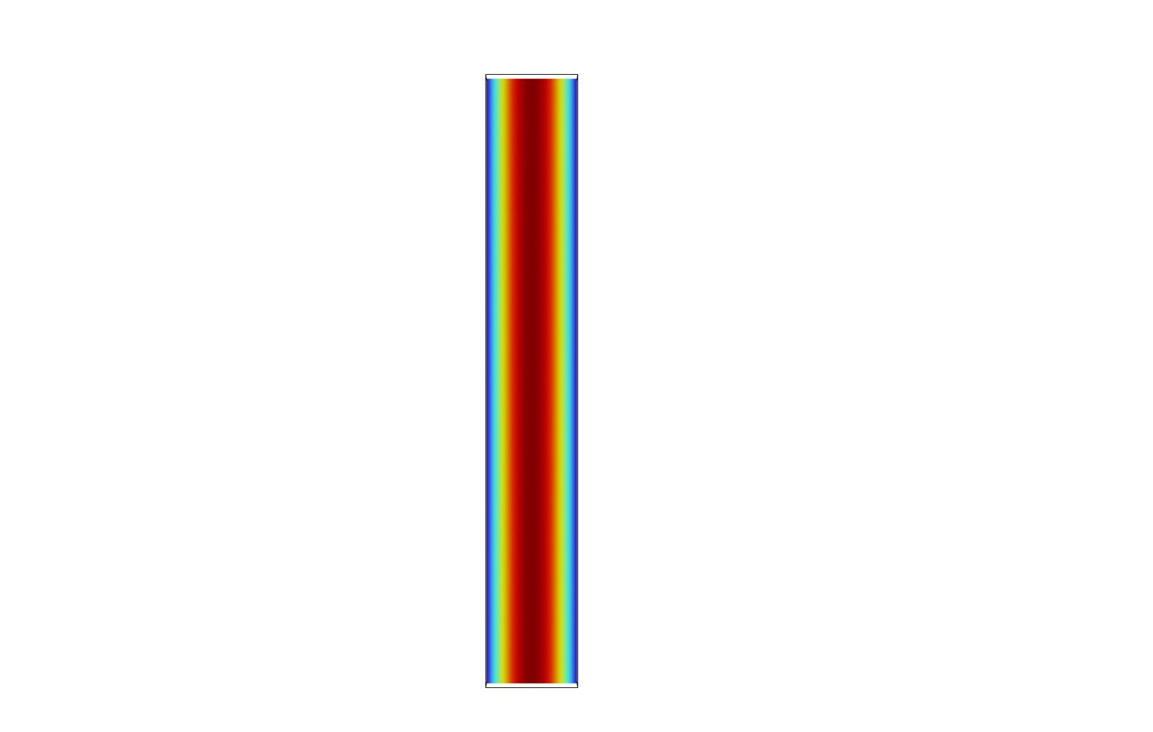

For laminar single phase flow through microchannel, When I put inlet and outlet condition: fully developed and wall as: No slip, I get fully developed profile from the very entrance of the channel. However when I Change the wall condition to Navier slip [20nm] while keeping both the inlet and outlet condition same, I dont get the fully developed profile from the very inlet.
Could anyone please explain the issue?

Certainly. A no-slip wall specifies a zero velocity at the wall as a constraint; whereas a slip wall will not. As such, the slip wall has no constraint in the wall-normal direction except the zero gradient which is present as a "natural" condition of the weak form used by the finite-element method.
