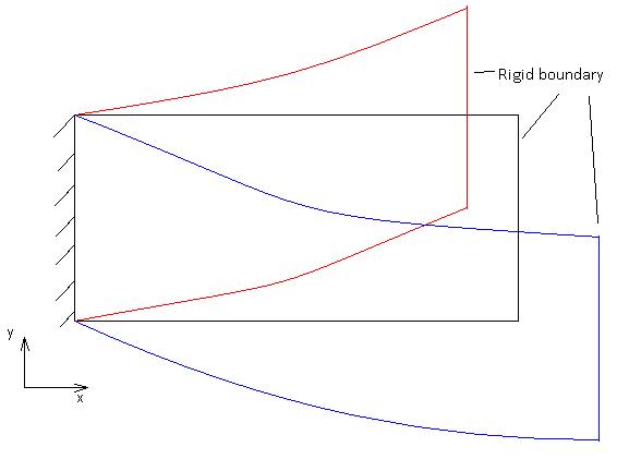

I have the structural module v3.5a, and I've been using the prescribed displacement BC, but I can not achieve my goal. Actually, what I need is a boundary condition of a super rigid wall (see example in attachment), which should not bend (must be parallel to 'y' axis), but it can move in any direction due to some external force.
I also tried with a new Coordinate System, but I haven't been able to obtain this result.

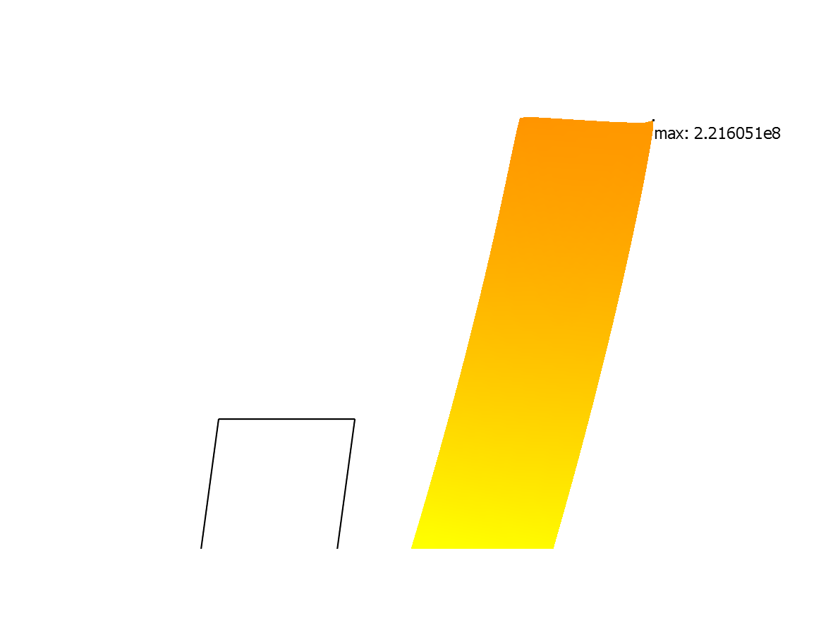

let mi join in. I did just as in example from smeug.pdf, but for 2D case, but what I get is not exactly what I want. I use ideal constraints, weak constraints are off. Any idea why the boundary of the deformed solid is not a straight line?
This straight line constraint is the only condition for this boundary.

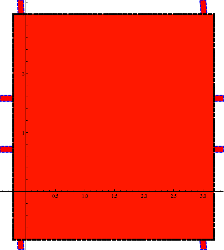

thank you for the answer. Let me quickly introduce the problem. In model.png there is a periodic unit cell. No matter what happens inside the cell, ends of these ''beams`` should remain compatible in terms of translation the unit cell. In other words the boundaries should be the same due to the periodicity (right-left, top-bottom).
My plan was to put left and bottom beams ends on the roller. For right ends there is a prescribed Rx and free Ry.
Until now we have all ends horizontal or vertical. The only boundaries to be constrained are the upper ends of the beams. That's why I wanted them to stay horizontal. But I realize this approach is not perfect.
Do you have an idea how my goal could be achieved?
