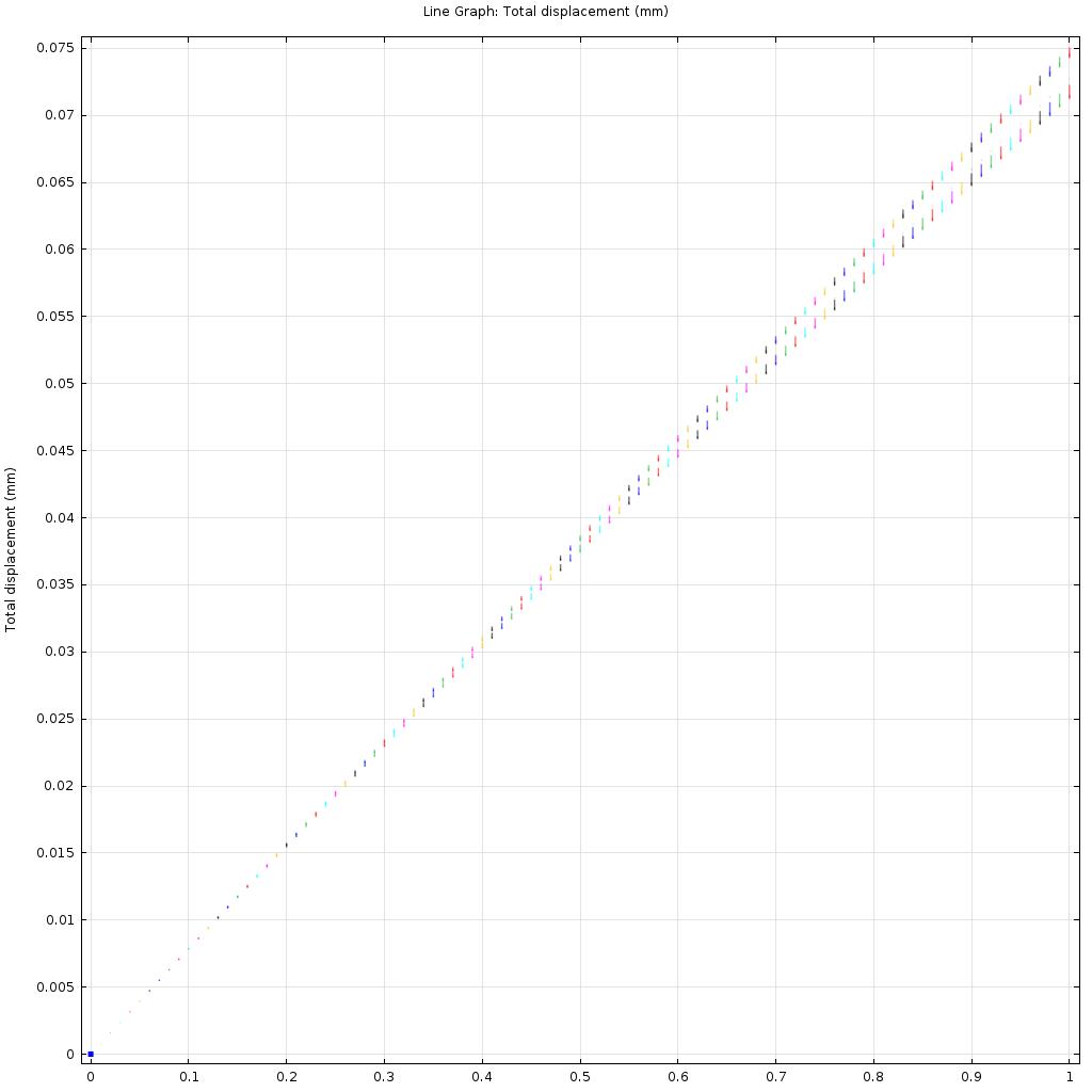

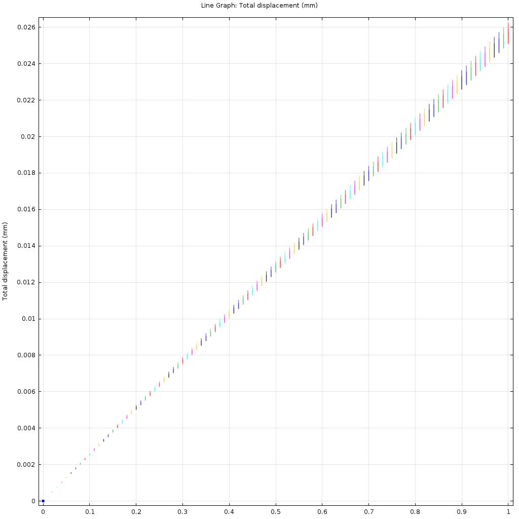

The connection between the three rectangles (epoxy, glass fiber, epoxy) is made via the thin elastic layer function in comsol 4.3b. This function works well. You can recognize this by comparing the 2 attached files. The first file have a total spring constant of 1e15 N/m and the other uses 1e8 N/m.
In the 1D-plot group 5 is the total displacement of the right edge over the parameter para (factor for the boundary load) pictured.
