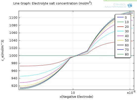

I have made a mistake.
The volume fraction and diffusion coefficient on both sides of boundary 3 may not be the same,
so there is sudden change in the gradient of electrolyte salt concentration.
Sorry to propose this stupid question.

I may have made a mistake in the original posts.
Please let me check it.

In the demo "capacity fade.mph" in 4.3a, the electrolyte salt concentration is continuous in domanin 2 (Negative electrode), domain 3(Separator), domain 4(Positive electrode).
But its flux is not continous in boundary 3 and 4, which link the three domain. This can be seen from the simulation results by downloading attached file or clicking the following seb albums address:
o6i1gw.bay.livefilestore.com/y2preQpl7xXbSJIg1wuTk2wLwFnyRawPsuTO8nHSAe7pPLfdV4ASWeuNpjJsTvdNMxDe2e6hUMQ-grQF09UNUb5_cnsQmKAPtSfdHtJJkcynuk/comsol_2.jpg?psid=1
The "capacity fade.mph" was established by referreing to reference [1], which didn't explicitly discuss the flux continuity problem on electrolyte salt concentration.
The reference [2], which is more authoritative, believed that the flux of electrolyte salt concentration c_l is continous between negative electrode and separator and between positive electrode and separator. (see fig.3 of reference [2]).
The reference [3] was also claiming the flux continuty by Eq.(8) and Eq.(9).
My questions are:
1. How the flux was determined, if it was not explicitly defined in "capacity fade.mph" or other battery demos.
2. How to make sure the flux is continous in this demo?
