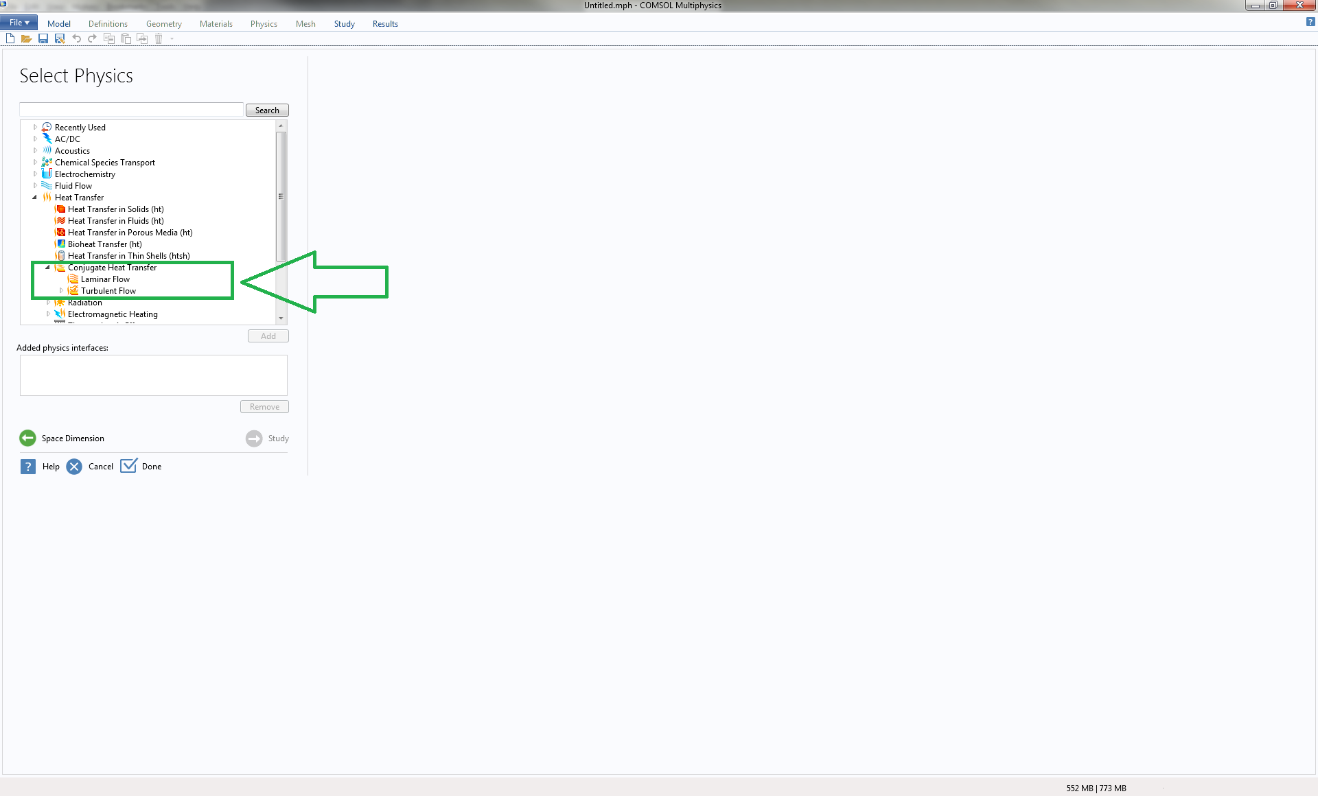

If your license includes either the CFD Module or the Heat Transfer Module (or both), there is a physics interface for Conjugate Heat Transfer that greatly simplifies setting up this sort of analyses - See screenshot and also www.comsol.com/products/specifications/heat-transfer/.
Hello Van, If your license includes either the CFD Module or the Heat Transfer Module (or both), there is a physics interface for Conjugate Heat Transfer that greatly simplifies setting up this sort of analyses - See screenshot and also http://www.comsol.com/products/specifications/heat-transfer/. Best regards, Jeff
