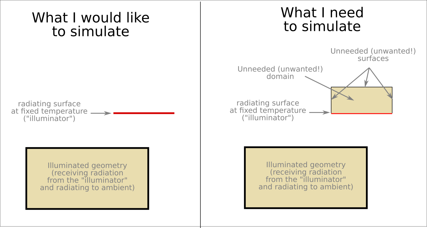

Rather than a COMSOL model, let me attach a picture illustrating the problem using an hypothetical simplified 2D model. Left is what I would like to obtain. Right is what I need to now, since I don't know how to include a radiating surface without it being part of a closed domain.
Hope this is clearer now.

Now again, the problem is: I have my domain representing the physical objects that are illuminated. I want to define a surface somewhere, at a fixed T>Tamb, that "illuminates" my object.
- If I create a domain (completely exterior to my illuminated objects, not "containing" them), then I can define one of its surfaces (looking towards the illuminated) as "emitting", and all works fine (see right panel on attached figure, in which I have colored the domain to make them easier to distinguish). However, I have the problem of having to include the additional domain, and its non-radiating faces, in the simulation.
- If I create just a surface, that would be ideal (left panel in the attached figure). Except, I do not know how to tell COMSOL to use that surface as a radiation source, since COMSOL only allows me to include domains, and not surfaces, in the "heat conduction" physics interface.
I hope it is now clear what my problem is...

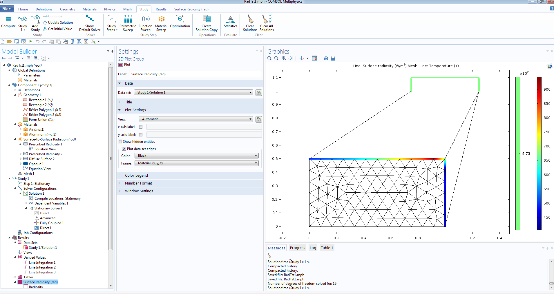

I have tried to regenerate your problem in the model below in v5.1.0.180
check carefully the doc too, I see now that COMSOL has nicely improved the capabilities since I used it last :)
Here I'm not solving for an T, I impose them you need to add the HT for that (or use the full HT+Rad case
Unfortunately I cannot open the model you attached, as I'm limited to COMSOL 5.0. However, by looking at the screenshot, I do have a comment: I don't think you need to insert the two extra domains (triangle and trapezoid) besides the two rectangles.
