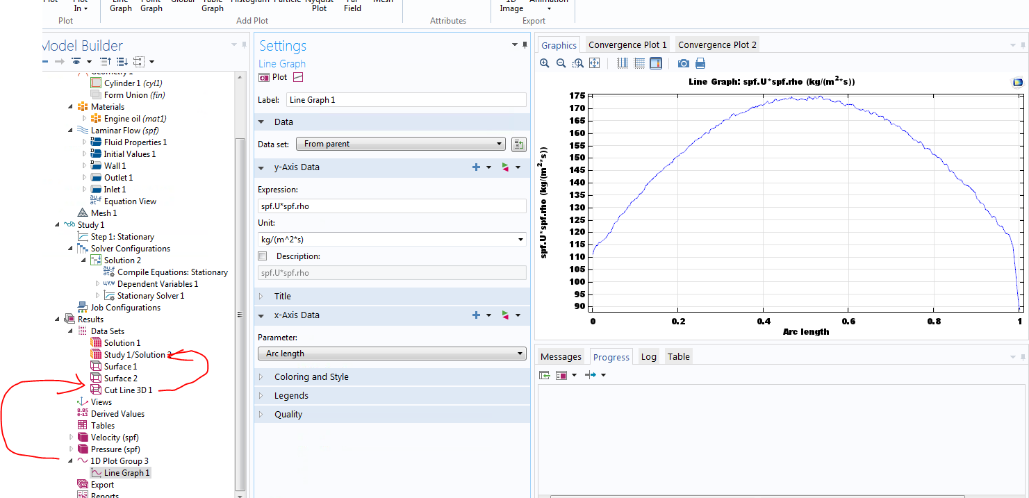

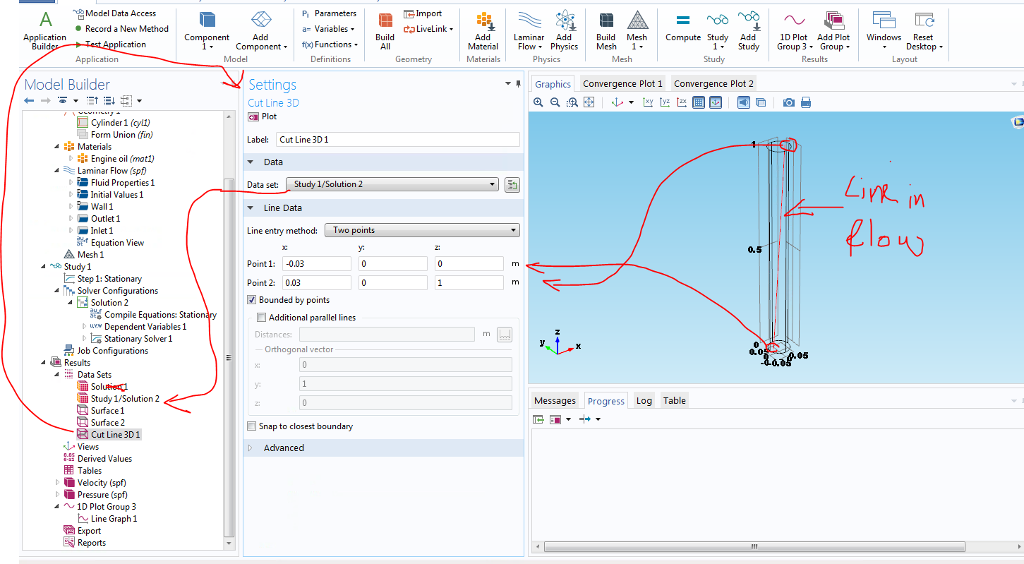

Could it be that you want to define a "Results - DataSet - Cut Line 3D" and plot spf.U*spf.rho thereon ?
If so I have joined two images below for a simple fluid in a tube case
But I'm not sure I got your question 100% right ;)
Hi OK in 3D, then I probably missed the concept of Line in your case. Could it be that you want to define a "Results - DataSet - Cut Line 3D" and plot spf.U*spf.rho thereon ? If so I have joined two images below for a simple fluid in a tube case But I'm not sure I got your question 100% right ;) -- Good luck Ivar
Posted: 1 decade ago 27 août 2015, 08:07 UTC+2
yes right , that exactly what I have,
in the plot, the unit is in (kg/m^2.S) , and we measure flow along the Line which is one dimension,so I was asking about how defined flux ( which is depends on area) along one dimension line
regads
yes right , that exactly what I have, in the plot, the unit is in (kg/m^2.S) , and we measure flow along the Line which is one dimension,so I was asking about how defined flux ( which is depends on area) along one dimension line regads
Posted: 1 decade ago 27 août 2015, 11:52 UTC+2
well it's on the image, no?: spf.U*spf.rho
which gives the local mass flux in kg /(m^2)/s : mass [kg] per perpendicular surface Area [m^2], per second [s]
if you want the total mass per second [kg/s] you need to integrate over the section surface, and define correctly which "normal" to use. i.e. integrate over the outflow surface check the equations under the hood (Preferences Equation View) => search for COMSOL internal variable "spf.out1.Mflow"
Hi well it's on the image, no?: spf.U*spf.rho which gives the local mass flux in kg /(m^2)/s : mass [kg] per perpendicular surface Area [m^2], per second [s] if you want the total mass per second [kg/s] you need to integrate over the section surface, and define correctly which "normal" to use. i.e. integrate over the outflow surface check the equations under the hood (Preferences Equation View) => search for COMSOL internal variable "spf.out1.Mflow" -- Good luck Ivar
