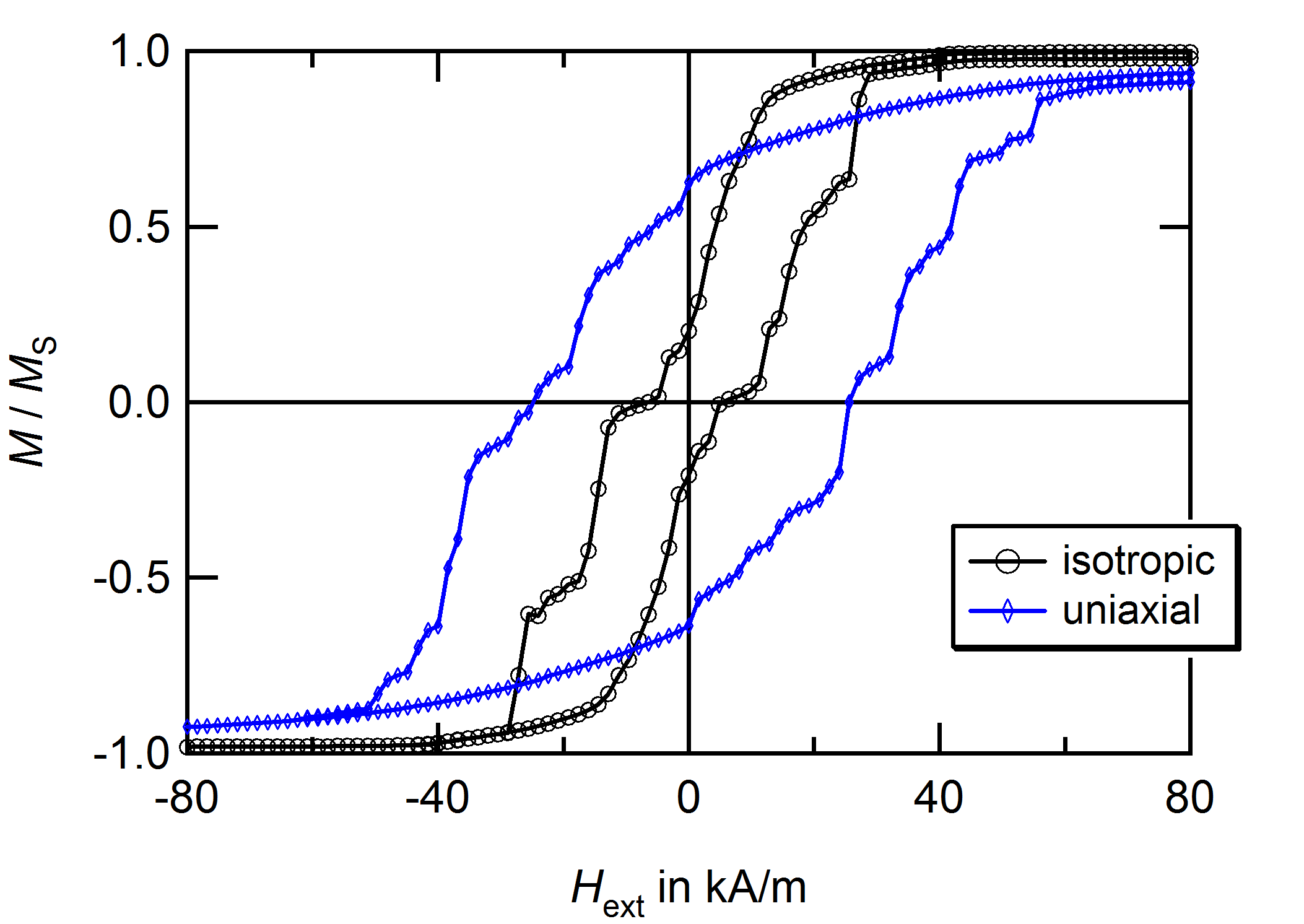

Hi everyone,
I do not know if you are still looking for an appropriate modeling approach. However, I attached a picture of a hysteresis loop calculated with COMSOL. For more information, see
www.comsol.com/community/forums/general/thread/22468/
Kind regards,
Alex
Hi everyone, I do not know if you are still looking for an appropriate modeling approach. However, I attached a picture of a hysteresis loop calculated with COMSOL. For more information, see http://www.comsol.com/community/forums/general/thread/22468/ Kind regards, Alex
