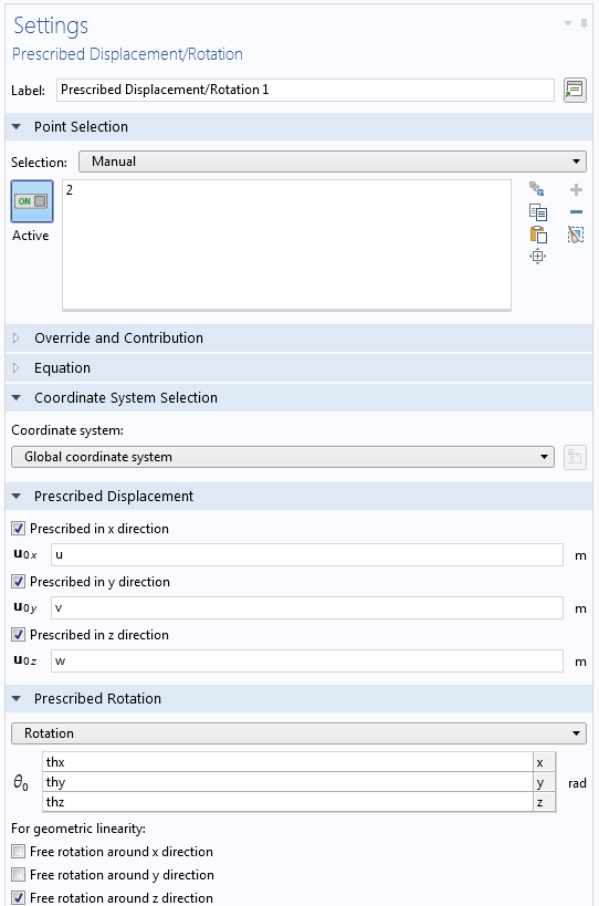

Posted: 6 years ago 28 juin 2019, 15:56 UTC+2
Hi Enrico,
I am not sure that I interpret your question correctly, but in the attached screenshot is how I would set up a model with a hinge around the z-axis. The Prescribed Displacement/Rotation node is present in the second Beam interface (beam2), so the values of (five of) the DOFs are ( at the common point) set to be equal to the corresponding DOFs in the first beam interface.
Henrik
Henrik Sönnerlind
COMSOL
Hi Enrico, I am not sure that I interpret your question correctly, but in the attached screenshot is how I would set up a model with a hinge around the z-axis. The Prescribed Displacement/Rotation node is present in the second Beam interface (beam2), so the values of (five of) the DOFs are ( at the common point) set to be equal to the corresponding DOFs in the first beam interface. Regards, Henrik
