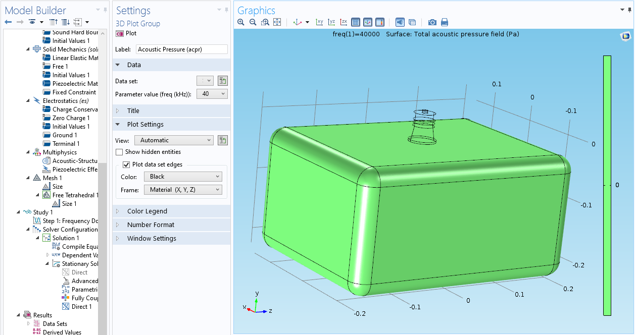

I am trying to study the effects of piezoelectric transducers on a fluid volume similar to traditional ultrasonic cleaning machines. I followed the piezoelectric COMSOL tutorial found here: https://www.comsol.com/video/piezoelectricsimulations-comsol-multiphysics . However, i was having trouble meshing the boundary layer between the fluid domain and the PML layer.

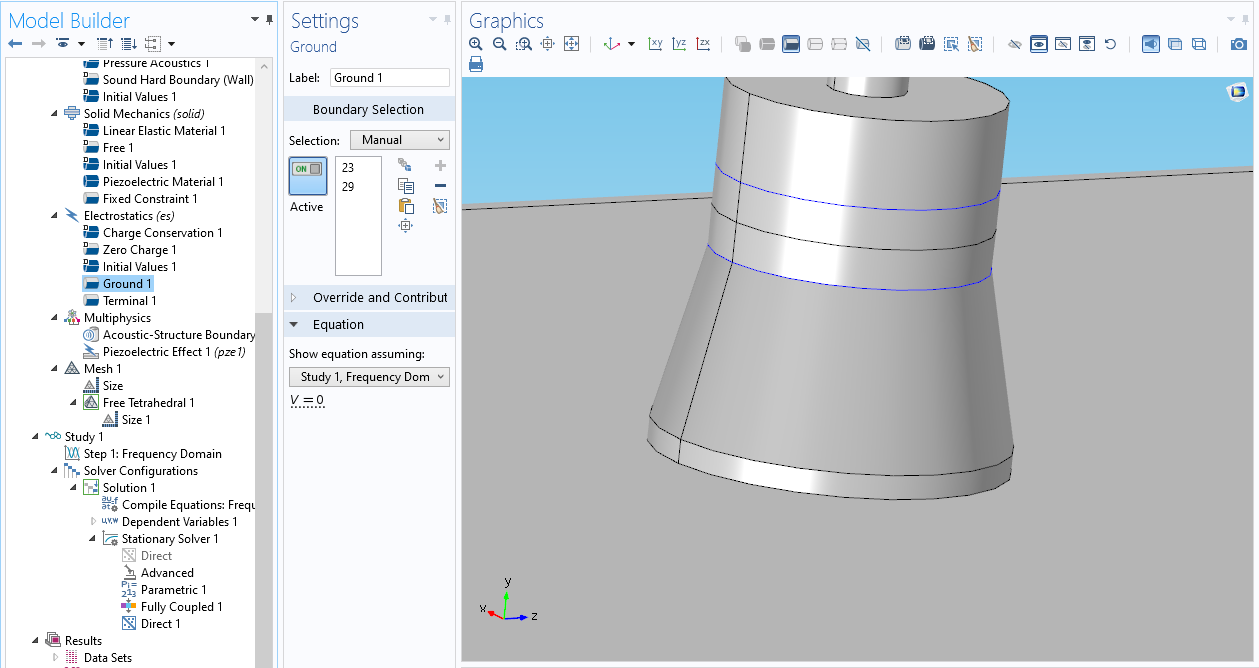

I instead attempted to study the effect on a domain that more closely resembles my project and chose not to use a PML layer- this time i got the model to mesh and run a frequency domain study, however i am not getting any values. Can anybody please help? Also, i am using a transducer with two layers of piezo electric material and i may have assigned the ground and terminal boundaries incorrectly.
If i get this study to return valid results, id like to run another one with multiple transducers and optimize pressure gradients within the control volume.
