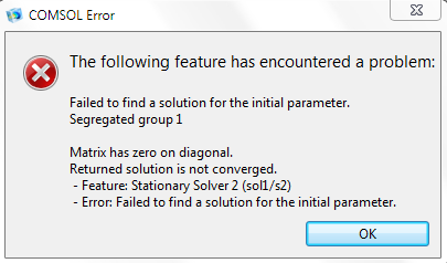

I mat a problem when simulate a AC/DC model.
it came out as below:
Failed to find a solution for the initial parameter.
Segregated group1
Matrix has zero on diagonal.
-Feature: stationary solver2(sol1/s2)
-Error: Failed to find a solution for the initial parameter.
any suggestions and help will be highly appreciated!
learn COMSOL, like COMSOL
your image does not tell much about your model though ;)
But, a "0" on the diagonal often indicates some non defined BC's or not enough Boundary conditions to solve correctly. Now you have also a segregated solver case, perhaps the unknown comes from the 2nd step and has not been caclualted, or that the initial values are too far from the final solution.
I can suggest: a) recheck all your BCs for all physics, ahve you defined enough PER physics ? b) check the initial conditions, are these reasonnable ("0" is seldom the most reasonable, once you know the model, but in all generalit for any type of model "0" is an as good guiess, now I hope that you have a specific model and that you have done your home works with a few expecedd values where to pass ...) c) try to use adirect solver (or move all unknown to step 1 and suppress step 2... (requires more RAM, OK for small models on large PC)
