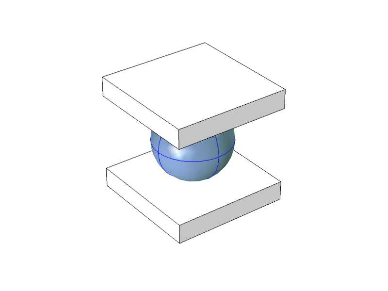

I need to simulate Thermal Heating and Mechanical Pressing in polystyrene microspheres. The setup is: I have two glass slides squeezing polystyrene microspheres inside a furnace at 180C and 700N. Can anyone suggest me a way to model this problem, and which physics to use?
Is coupling Heat Transfer and Structural Mechanics a good idea?

take a look at "TS" which is HT+Solid together
Hi take a look at "TS" which is HT+Solid together -- Good luck Ivar
