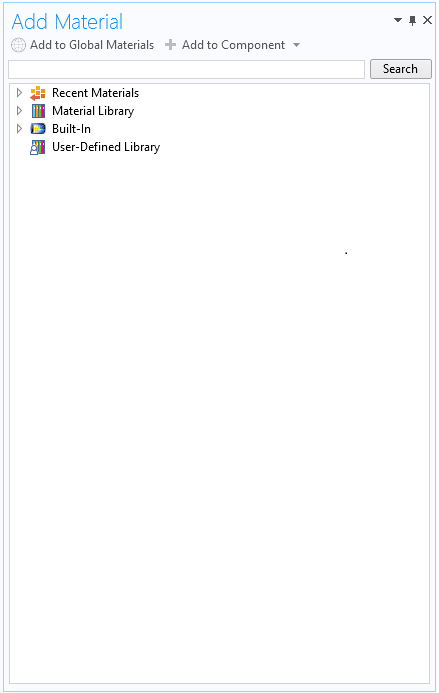

                                                    I checked and it seems, that I have only "Material Library" in that list. So without AC/DC module is it impossible to do electromagnetic simulations with just simple COMSOL basic pack?
From the other hand, what is the purpose of this "Material Library" if it doesn't include even most common magnetic material "Soft Iron"?

Electromagnetics is a broad field, so we need to look at it piece by piece. Some electrostatics, DC current and magnetic fields simulations can be performed without any of the physics-based module. For low frequency electromagnetics the AC/DC Module is usually needed; that module also adds functionalities for electrostatics, DC current and magnetic fields. For high frequency electromagnetics, you will need the RF Module or Wave Optics Module. For Optics, the Ray Optics Module is available. A detailed listing of the features of each of those products can be found in the Specification Chart.
We offer a general purpose Material Library product, which, based on what you've reported, is on your license. Some of the physics-based modules also include additional material libraries specific to the fields covered by those products.
Regardless of which optional products your license includes, a number of materials are included in the core COMSOL Multiphysics (Iron being one of those materials found in the "Built In" folder), and the end user can always add materials and store them in user libraries, see for instance Reference Manual for COMSOL Multiphysics version 5.6, page 804 and following for more information.
