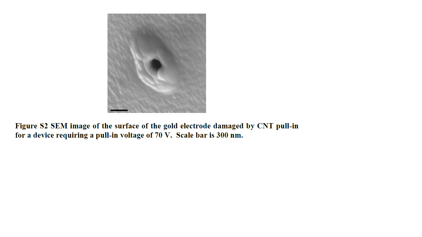

I've been through all the Joule heating and MEMS examples, but they conveniently use very low voltages as inputs. For example in the MEMS Joule heating example, they do a parametric sweep between 3 mV and 10mV. Reaching a maximum of 792K. However if I change the voltage to 200mV, the temperatures rise up to 1.2*10^5 K. I did some hand calculations and maybe the temperature isn't that bad. However, all the papers I've checked while doing this project have used voltages as high as 48V and It seems ther isn't any supernova reported in any of them. I know there should be really high temperatures when you reach voltages as high as 70V and there must be superheating effects like the one in the photo attached, but It seems that they can live with voltages of 5-20 V.
