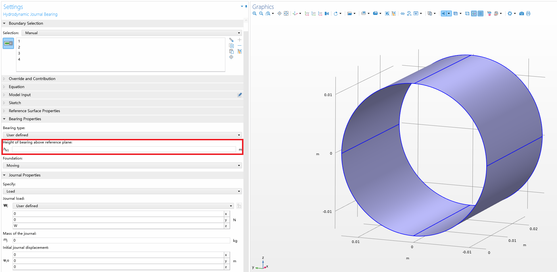

However, according to the COMSOL help file, the clearance is a function of polar coordinates.
Where a is the coordinate of a point on the bearing surface along the bearing axis. phi is the azimuth angle of a point on the bearing surface with respect to the local y direction of the bearing.

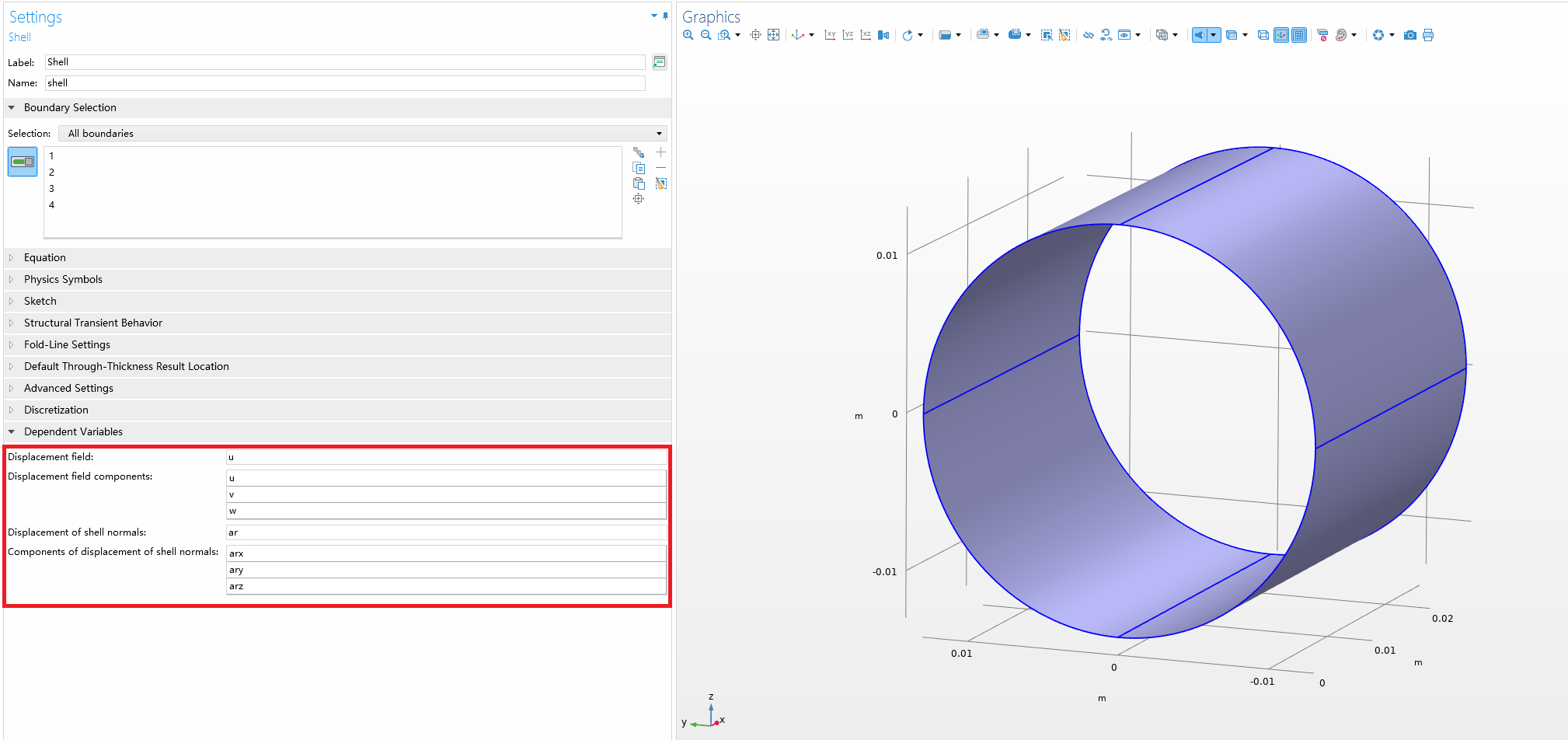

I need to find out the relationship between clearance, a and phi as shown in Figure 1. But the result of the deformation of the shell lies in Cartesian coordinates as shown in Figure 2. The figures are in the attachment.
I tried to use the expression
where C is a constant and shell.u is the displacement of the shell. But the variable shell.u is the absolute value of the displacement, and it can't distinguish between inward depression and outward projection.
