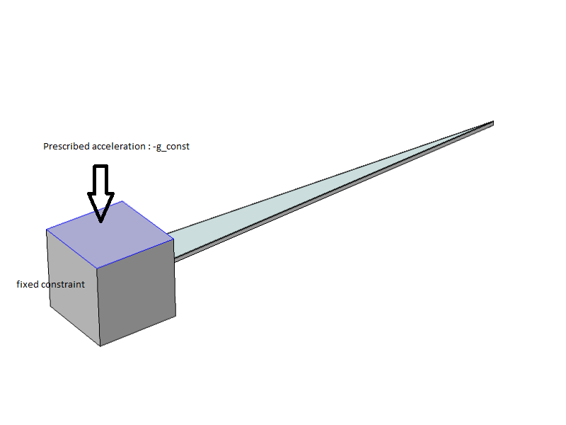

I am doing a project simulating a simple beam structure vibrated by a shaker. The left end of the beam is fixed with the shaker. If I want to set the beam vibration acceleration at 10 m/s^2, how can deal with this boundary condition?
Thank you all in advance!

You can apply a prescribed acceleration to the beam end that is fixed to the shaker. If you want the steady state response you should do a frequency domain analysis, set the frequency in the Study settings and just prescribe an acceleration of 10.0. Otherwise, you should perform a time dependent analysis and prescribe the acceleration such as 10.0*sin(omega*t).

take a little care the prescribed acceleration: it is a body load.
I would rather say a shaker is applying a force boundary load, hence running a harmonic solver would give you the frequency response. And with a little fiddling you can get a Bode plot, as these are not (yet I hope) implemented as such

I don’t think so Ivar. Prescribed acceleration in the Solid Mechanics modules is a boundary condition, just like prescribed displacement except that it is only applicable to time dependent and frequency domain problems.

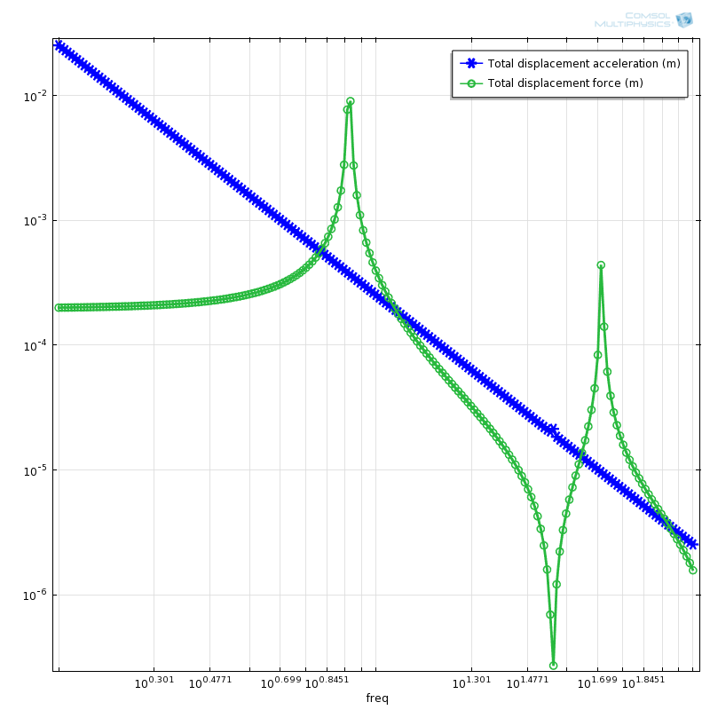

If you apply a shaker test (on a beam just to have an example) you have basically (at least) 2 possibilities:
1) you place the full system on the shaker and you apply a body load from the acceleration of the shaker (your fixed point is also shaking ! hence this is not "just" using the acceleration boundary or domain body load on a fixed lever
2) you attach a boundary to the shaker and you apply locally an excitation force, but the fix point is "fixed" inertially
the responses are different see below.
Take a beam 1, 0.1, 0.01 m^3 (x,y,z) size in structural steel. Attach "fixed" boundary 1 (the first small 0.1x0.01m^2 or y,z plane side), load boundary 6 (the other end of the beam) with an acceleration and then with a Force (both in Z), and do a harmonic scan of the type f=10^{range(0,0.01,2)}
then plot in log/log (or adapt to dB) mode the average "w" or "disp" value of the excited boundary "6" you will not get the same response.
Then, try a domain acceleration => its all wrong so long you do not replace the "fixed" boundary condition by something adapted to the acceleration motion,
something to think over ;)
That is why using COMSOL is fun, you can test quickly on simple examples without braking anything

Posted: 1 decade ago 6 sept. 2011, 08:06 UTC+2
if you impose an acceleration or a prescribed displacement the response is fixed your harmonic displacement is given or driven via acc=iomega^2*disp
Tryo use a boundary force of 1[N] then you will see the bodeplot if you plot the average tip displacement versus frequency (see my previous graph image above)

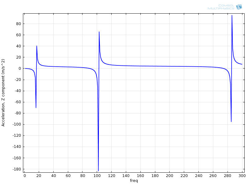

Posted: 1 decade ago 14 janv. 2012, 21:18 UTC+1
This post is a little bit old but maybe someone can help me.
I am trying to do this exact same thing but with a prescribed displacement reprsenting the shaker and I am a bit confused, I try to apply the displacement to the fixed end of the beam and it clear overrides my fixed constraint and my simulation fails.
Am I missing something?
Is there something other than a prescribed displacement that I should be applying?

Posted: 1 decade ago 16 janv. 2012, 22:42 UTC+1
Hi Ivar,
Thank you for the response.
What I actually have is Acceleration vs frequency data that i would like to input, so I'm looking to run a frequency study but instead of having a single constant acceleration I would like to have it varying depending on the frequency value.
It seems like this might be possible but I was getting stuck even applying just an acceleration.

Posted: 1 decade ago 16 janv. 2012, 23:15 UTC+1
I believe it should be possible with a fequency sweep (harmonic) solver and link the bondary acceleration amplitude to the frequency by an appropriate equation
Hi I believe it should be possible with a fequency sweep (harmonic) solver and link the bondary acceleration amplitude to the frequency by an appropriate equation -- Good luck Ivar
Posted: 1 decade ago 17 janv. 2012, 14:04 UTC+1
Thanks again Ivar, your suggestion of using the rollers seems to have worked out very well

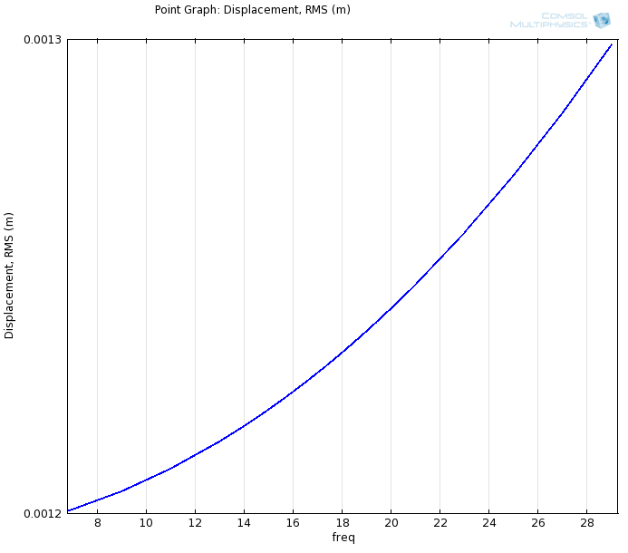

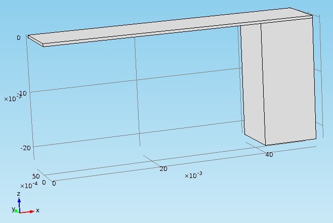

Hello everyone,
I've got a similar problem with a simulation of a vibration test. For easy understanding and a fast simulation I have simplified the model to a beam with the dimensions 1m * 0,02m * 0,02m (x, y ,z), which is fixed on the left end. Now this cantilever should be excited by an acceleration, but I don't know how to define this acceleration in the simulation. The first try was to define a boundary "prescribed acceleration" at the fixed end of this beam, but then the first condition gets overwritten, which is definitely wrong. I've also tried to simulate the beam of Ivar and the same results came out, but this is not the same task. I need a frequency-acceleration plot of this model, where the acceleration amplitudes of this cantilever can clearly be seen due to the eigenfrequencies of it. For example (acceleration of 5 m/s²), for the first 10 Hz there is almost a constant acceleration of 5 m/s², but at the first eigenfrequency of about 16 Hz there is a gain of xxx Q. After that the acceleration goes down and gets higher again at the second eigenfrequency, and so on.
So, how can I simulate this task, where should the acceleration act and also which kind of acceleration should act?
Thank you in advance for your help!!

what about using a body load of solid.rho*acceleration. If you want to do a sinus load case, try the frequency harmonic solver with a frequency span start-stop, and perhaps a frequency dependent acceleration.
I'm too missing a simple template as part of COSMOL by default to enter a PSD curve for load definition, so one need to make a function and a parametric PSD input shape, and it works ;)

I'm not by my WS so I cannot test it out, but why shouldt the amplitudes be correct ? If you apply a body load of g_const*solid.rho its gravity load, and this has always worked for me ;)
What you might see is the Q facor amplification, when you excite the resonance, have you added some damping in your system ? to make it more ralistic ?
Normally, the stress is related to the displacement, so if the displacement is not realistic, certainly the stress is neither not correct.
Have you found the frequency domain solver, check the equation view to see what you can do and what is considered.
One can transfor a PSD to an equivalent frequency sinus sweep response (in LTI system) check the web on virations loads, our the litterature

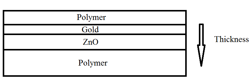

Posted: 1 decade ago 16 mai 2012, 23:17 UTC+2
Ivar,
First let me thank your for your quick and detailed response. I have few questions regarding your suggestions,
1) I am a beginner with Comsol and I do not know what should be the GND, floating potential, terminal settings. I find the manual insufficient to make users understand these features. They do not have any solved examples on the website. I have searched through this blog to find out worked out models shared by other users but unfortunately there are very few and what is worse is that they are in Comsol 4.2. I would request you to share with us some model on "Piezoelectric accelerometers". This would help many other users who are beginners.
2) I have ZnO as piezoelectric material. Gold is used as an electrode. I can model it as a thin layer. But I can not fild 'thin layer' primitive under the geometry node. Is this something available in the newer versions? I have 4.1.
3) I have tried using 3 elements along the thickness of every element. The natural frequency and the mode shape is the same, but the software is still incapable of performing a frequency sweep.
4) The bottommost and the topmost layers are polymer, so they are not conductors. Frankly, I do not know what electrical connections need to be used for obtaining the voltage and charge generated in the piezolayer during frequency sweep.
I do not want to give up.
-Sankha
Ivar, First let me thank your for your quick and detailed response. I have few questions regarding your suggestions, 1) I am a beginner with Comsol and I do not know what should be the GND, floating potential, terminal settings. I find the manual insufficient to make users understand these features. They do not have any solved examples on the website. I have searched through this blog to find out worked out models shared by other users but unfortunately there are very few and what is worse is that they are in Comsol 4.2. I would request you to share with us some model on "Piezoelectric accelerometers". This would help many other users who are beginners. 2) I have ZnO as piezoelectric material. Gold is used as an electrode. I can model it as a thin layer. But I can not fild 'thin layer' primitive under the geometry node. Is this something available in the newer versions? I have 4.1. 3) I have tried using 3 elements along the thickness of every element. The natural frequency and the mode shape is the same, but the software is still incapable of performing a frequency sweep. 4) The bottommost and the topmost layers are polymer, so they are not conductors. Frankly, I do not know what electrical connections need to be used for obtaining the voltage and charge generated in the piezolayer during frequency sweep. I do not want to give up. -Sankha
Posted: 1 decade ago 17 mai 2012, 08:47 UTC+2
I agree with you that in the beginning it's slightly confusing. This I believe comes from the fact that very few users take the time to learn the COMSOL notations and manage to get it linked to our (diverse) way of doing math and physical math. I can also recommend the introduction and advanced courses by COMSOL, I learned a lot with these.
My main suggestion is: start simple, build your models step by step, understand the essentials, then go to the more complex.
For the versions certainly the to come 4.3 will be a big step towards better stability and many new functionality w.r.t your old 4.1
To come back to your model, you need to better understand the differences of the main physics nodes and sub nodes. Which dependent variables are needed where. Linear material, PZT material, ...
And w.r.t meshing, ensure you always have 2-3 elements in the thickness with layers, otherwise you cannot resolve the fields and gradients across the thickness, which means you are better off with a "thin layer physics" where the thickness is a parameter. This reduces the mesh size and DoFs too and often gives better results (than a poorly meshed membrane), not to say quicker solving
Normally one uses the PZD physics (pre-cooked by COMSOL) define the non-pzt material domains as linear elastic, and keep ONLY the PZT paterial in the default PZD anisotropic physics domain. Then one should use GND and a terminal on the appropriate boundaries for the electrodes (à PZT behaves mechanically different if the wires are connected or free). And do not forget that with multiple physics you need enough BC PER physics and dependent variables to get an unique solution of your PDEs

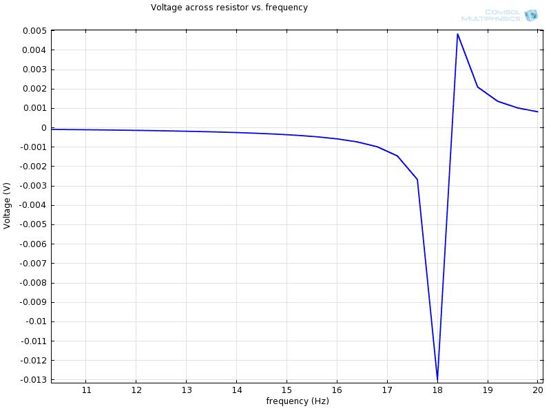

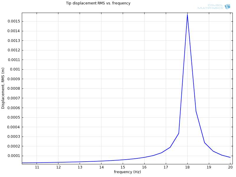

Hi, I am doing the simulation with the cantilever coated by piezo material. When I do the frequency sweep, the cantilever tip displacement and output voltage reach its highest at the resonant frequency. My question is why there is a voltage leap from the negative to positive.
Thank you!
Hi, I am doing the simulation with the cantilever coated by piezo material. When I do the frequency sweep, the cantilever tip displacement and output voltage reach its highest at the resonant frequency. My question is why there is a voltage leap from the negative to positive. Thank you!
Posted: 1 decade ago 27 juin 2012, 16:45 UTC+2
it has probably to do with the phase lag of your signal which inverses, before the resonance you are driving it, after its the resonance that is ahead of your excitation
Difficult to say more without running a full case
Hi it has probably to do with the phase lag of your signal which inverses, before the resonance you are driving it, after its the resonance that is ahead of your excitation Difficult to say more without running a full case -- Good luck Ivar
Posted: 1 decade ago 27 juin 2012, 16:51 UTC+2
It is probably a phase issue as Ivar mentioned. Even without piezo effects, before resonance phase angle between force and displacement is 0 and after resonance it is 180 degrees (there is a gradual transition when there is damping).
Nagi Elabbasi
Veryst Engineering
It is probably a phase issue as Ivar mentioned. Even without piezo effects, before resonance phase angle between force and displacement is 0 and after resonance it is 180 degrees (there is a gradual transition when there is damping). Nagi Elabbasi Veryst Engineering
Posted: 1 decade ago 27 juin 2012, 17:10 UTC+2
indeed for force versus displacement, but if I got it right here it was V out versus force ?
Hi indeed for force versus displacement, but if I got it right here it was V out versus force ? -- Good luck Ivar
Posted: 1 decade ago 27 juin 2012, 17:16 UTC+2
Is it because Force and the induced Voltage are always in the same phase?
Posted: 1 decade ago 27 juin 2012, 19:03 UTC+2
if you have a PZT beam, fixed at one end and loaded by a varying force load at the other end, then the force will introduce a deformation of the beam, hence a stress build-up. This stress buildup will generate charges that will populate the electrodes hence induce an electric field across the PZT, this field will vary if the electrodes are free, or grounded (short) or hooked up to some other intermediate or complex impedance. Now the electric field will act on the stiffness tensor and change the deflection hence the response and off we are with a chicken an the egg story: who came first ?
So I would say your foce induces a flexing whcih nitroduces a stress change with induces a potential. But you can loop the other way too ;)
Normally you can simulate the eigenfrequency change if your electrodes are shorted or pen loop, the difference in frequency gives yout the elecric to mechani coupling factor "k"
As you have losses in the PZT and perhaps in the driving circuit of your PZT you will get complex responses so you mst study the behaviour with Bode plots for the amplitude "abs(...)" and the phase "atan2(imag(...),real(...))"
Hi if you have a PZT beam, fixed at one end and loaded by a varying force load at the other end, then the force will introduce a deformation of the beam, hence a stress build-up. This stress buildup will generate charges that will populate the electrodes hence induce an electric field across the PZT, this field will vary if the electrodes are free, or grounded (short) or hooked up to some other intermediate or complex impedance. Now the electric field will act on the stiffness tensor and change the deflection hence the response and off we are with a chicken an the egg story: who came first ? So I would say your foce induces a flexing whcih nitroduces a stress change with induces a potential. But you can loop the other way too ;) Normally you can simulate the eigenfrequency change if your electrodes are shorted or pen loop, the difference in frequency gives yout the elecric to mechani coupling factor "k" As you have losses in the PZT and perhaps in the driving circuit of your PZT you will get complex responses so you mst study the behaviour with Bode plots for the amplitude "abs(...)" and the phase "atan2(imag(...),real(...))" -- Good luck Ivar
Posted: 1 decade ago 22 juil. 2012, 02:44 UTC+2
I've tried applying 'prescribed acceleration' to the fixed end of the beam and managed to get the 'voltage vs freq' plot. However, when i do analysis of the beam's deformation at every single frequency, I've found out that the fixed end of the beam moves. It stays fixed only at the natural frequencies. I believe this might be due to 'fixed constraint' is overridden by 'prescribed acceleration'. If 'fixed constraint' overrides 'prescribed acceleration', there will be no output voltage generated.
If I changed the 'prescribed acceleration' to 'body load' of "pzd.rho*acceleration", the fixed end stays fixed throughout the simulation. However, I noticed that the list of eigenfrequencies changed and I'm not sure why.
If I want to plot the voltage distribution at every point accross the length of the beam, should i choose "electric field-Z component"?
Hi, I've tried applying 'prescribed acceleration' to the fixed end of the beam and managed to get the 'voltage vs freq' plot. However, when i do analysis of the beam's deformation at every single frequency, I've found out that the fixed end of the beam moves. It stays fixed only at the natural frequencies. I believe this might be due to 'fixed constraint' is overridden by 'prescribed acceleration'. If 'fixed constraint' overrides 'prescribed acceleration', there will be no output voltage generated. If I changed the 'prescribed acceleration' to 'body load' of "pzd.rho*acceleration", the fixed end stays fixed throughout the simulation. However, I noticed that the list of eigenfrequencies changed and I'm not sure why. If I want to plot the voltage distribution at every point accross the length of the beam, should i choose "electric field-Z component"? Thanks
Posted: 1 decade ago 22 juil. 2012, 09:06 UTC+2
indeed if you apply a prscribed acceleration, your object CANNOT be fixed these are antogonists. What you can do is to apply a body load of the type "material.rho*my_acceleration" and keep the fixed section "fixed".
I'm neither not fully happy as today I have not found a clean way to apply a shaker type PSD on a model, in a simple way. there are several threads about this on the Forum, try a search
Hi indeed if you apply a prscribed acceleration, your object CANNOT be fixed these are antogonists. What you can do is to apply a body load of the type "material.rho*my_acceleration" and keep the fixed section "fixed". I'm neither not fully happy as today I have not found a clean way to apply a shaker type PSD on a model, in a simple way. there are several threads about this on the Forum, try a search -- Good luck Ivar
Posted: 1 decade ago 1 août 2012, 06:04 UTC+2
Hi Ivar,
From the attached figure, does my model represent a beam subjected to base excitation? (the beam is attached to a big rigid mass). I've applied body load before to the rigid mass but the output voltage generated is maximum at the fifth eigenfreq. If I changed it to prescribed acceleration and applied it on top of the rigid mass, I can see that the maximum value of voltage is at the first eigenfreq (which is theoretically correct according to my understanding)
thanks
Hi Ivar, From the attached figure, does my model represent a beam subjected to base excitation? (the beam is attached to a big rigid mass). I've applied body load before to the rigid mass but the output voltage generated is maximum at the fifth eigenfreq. If I changed it to prescribed acceleration and applied it on top of the rigid mass, I can see that the maximum value of voltage is at the first eigenfreq (which is theoretically correct according to my understanding) thanks
Posted: 1 decade ago 1 août 2012, 06:43 UTC+2
However, by applying prescribed acceleration, the value of voltage is hundreds volts, which is I think is not correct
Posted: 1 decade ago 2 août 2012, 20:29 UTC+2
from you image, you should not use fixed and acceleration simulatneously, but you must use two roller conditions on two opposite sides of your sqare mass at right angle to the acceleration direction. Be sure you large mass is "large" compared to the beam, and then get the correct estimate of the true load on the beam
100V is not necessarily that much, you can get a sparck (>1kV) easily with a stressed PZT, but this also depends strongly on the impedance you connect up on your PZT
Hi from you image, you should not use fixed and acceleration simulatneously, but you must use two roller conditions on two opposite sides of your sqare mass at right angle to the acceleration direction. Be sure you large mass is "large" compared to the beam, and then get the correct estimate of the true load on the beam 100V is not necessarily that much, you can get a sparck (>1kV) easily with a stressed PZT, but this also depends strongly on the impedance you connect up on your PZT -- Good luck Ivar
Posted: 1 decade ago 3 août 2012, 07:37 UTC+2
I think I'd better stick with your initial suggestion that is to apply body load. I use steel as the large mass due to its stiffness and aluminum beam. I apply fixed constraint to the faces of the mass except for the one that is attached to the beam.
I'm currently using one physics only that is piezoelectric device. I apply floating potential to the top of the PZT and ground at the bottom of the layer and this is how I extract the voltage generated Do I need to add another physics(i.e electrical circuit) for the impedance?
Hi I think I'd better stick with your initial suggestion that is to apply body load. I use steel as the large mass due to its stiffness and aluminum beam. I apply fixed constraint to the faces of the mass except for the one that is attached to the beam. I'm currently using one physics only that is piezoelectric device. I apply floating potential to the top of the PZT and ground at the bottom of the layer and this is how I extract the voltage generated Do I need to add another physics(i.e electrical circuit) for the impedance? Thanks
Posted: 1 decade ago 3 août 2012, 10:41 UTC+2
indeed fixing your block and applying a body load as an acceleration is o good way, in a frequency domain sweep you can get the frequency response too of your system. If you leave a floating potential its as if you have an open circuit, you voltage will be given by the charge build-up and the PZT beam capacity. If you add a CIR physics with an electric impedance of some kind, i.e. representing the entry impedance of your system, then you will see the response and voltage build up of your device in loaded conditions. One way to optimise the energy transfer is to play with the bandpass of your load impedance and the response of the beam
Hi indeed fixing your block and applying a body load as an acceleration is o good way, in a frequency domain sweep you can get the frequency response too of your system. If you leave a floating potential its as if you have an open circuit, you voltage will be given by the charge build-up and the PZT beam capacity. If you add a CIR physics with an electric impedance of some kind, i.e. representing the entry impedance of your system, then you will see the response and voltage build up of your device in loaded conditions. One way to optimise the energy transfer is to play with the bandpass of your load impedance and the response of the beam -- Good luck Ivar
Posted: 1 decade ago 3 août 2012, 18:33 UTC+2
Thanks a lot. you've been really helpful
Hi Thanks a lot. you've been really helpful

Posted: 1 decade ago 12 déc. 2012, 04:32 UTC+1
I've applied body load to represent base excitation, and assigned "added mass" BC at the free end of the cantilever ( to represent tip mass). Howver, it shows that the voltage output at the eigenfreq keeps decreasing as the "added mass" increases. I believe by adding the tip mass, the voltage will be increased.
Hi, I've applied body load to represent base excitation, and assigned "added mass" BC at the free end of the cantilever ( to represent tip mass). Howver, it shows that the voltage output at the eigenfreq keeps decreasing as the "added mass" increases. I believe by adding the tip mass, the voltage will be increased. Thanks
Posted: 1 decade ago 12 déc. 2012, 07:33 UTC+1
if you add an "added mass then you must also add a boundary force, as the body load applies ONLY forces to the DOMAIN, not to the added mass that is a separate "fictuous " entitiy do not forget that ;)
Hi if you add an "added mass then you must also add a boundary force, as the body load applies ONLY forces to the DOMAIN, not to the added mass that is a separate "fictuous " entitiy do not forget that ;) -- Good luck Ivar
Posted: 1 decade ago 13 déc. 2012, 05:45 UTC+1
The added mass reduces the natural frequency so the voltage may be dropping because the frequency you specified in the frequency domain analysis is no longer close to the beam’s natural frequency.
Posted: 1 decade ago 13 déc. 2012, 06:18 UTC+1
thanks for the reply. in the frequency analysis, I've specified a range of frequency, the eigenfrequency lies within that range.
Thanks.
Hi, thanks for the reply. in the frequency analysis, I've specified a range of frequency, the eigenfrequency lies within that range. Thanks.
Posted: 1 decade ago 13 déc. 2012, 18:03 UTC+1
Ok, one more thing to check. Conceptually, if you apply a certain body load and you change the structure by adding mass the deformations should in general be lower and also the voltage.
Posted: 1 decade ago 13 déc. 2012, 18:59 UTC+1
Hmm,may I know why? Because from what I understand, Adding tip mass to the structure increases the strain,which eventually increases the deformation. Body load is assigned on the "large" mass attached to the beam and added mass is assigned at the other end of the beam,together with boudary load
Hmm,may I know why? Because from what I understand, Adding tip mass to the structure increases the strain,which eventually increases the deformation. Body load is assigned on the "large" mass attached to the beam and added mass is assigned at the other end of the beam,together with boudary load Thanks
