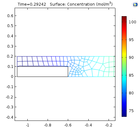

I have built a COMSOL 2D model that uses deformed geometry, where the geometry movement is non uniform. I need to use Automatic Remeshing to update the mesh elements. But after some time (t = 0.29s) it fails.
I tried using moving mesh, mesh refinement as well as segregated solver, but I am unable to get rid of this error. I need to know why this error keeps popping up, and whether there is something that I am missing.
I have given the error, as well as the warning below, and also attached the wireframe and surface plots of the concentration before the error.
Any help would be appreciated.
Thanks.

Based on my understanding the problem is with your boundary conditions. Did you solve it finally?
