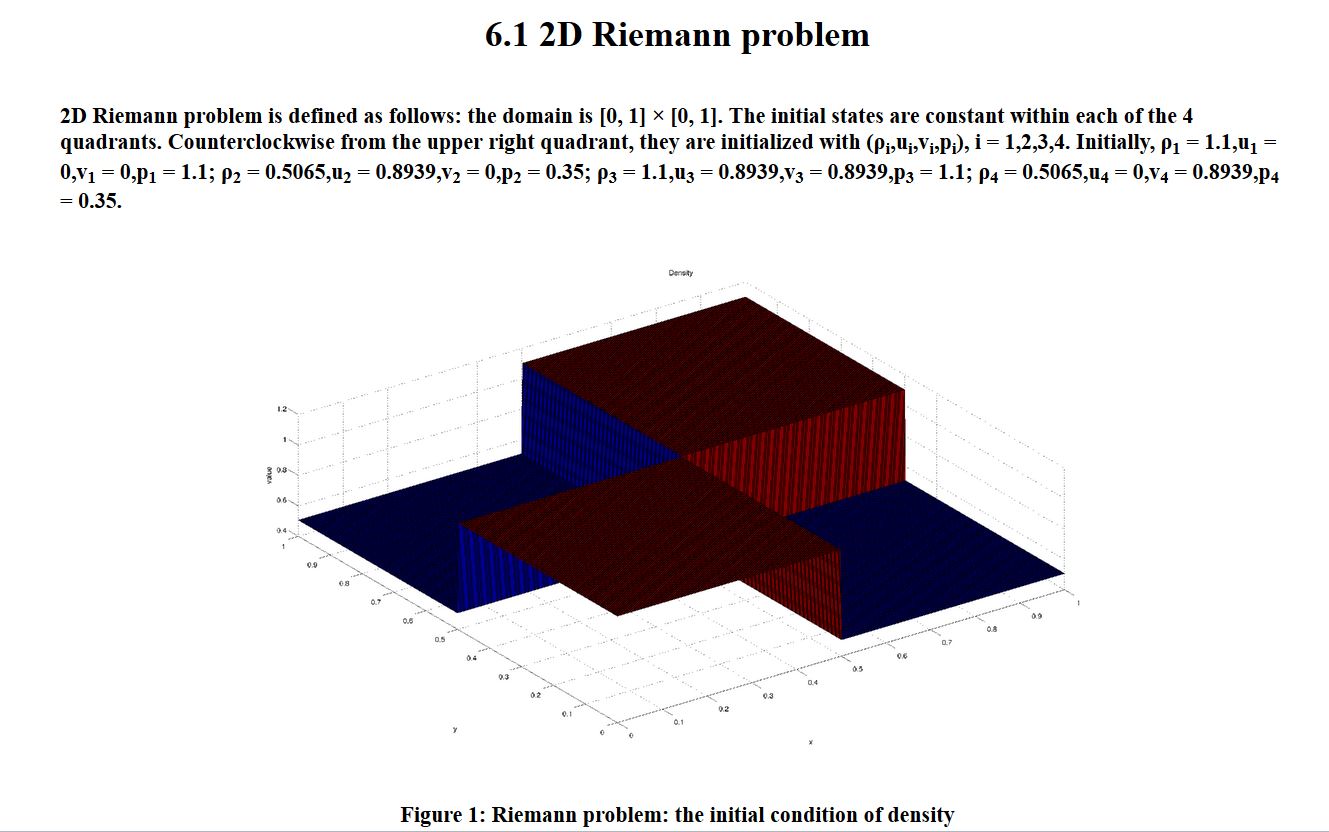

The initial condition is read from a 2D Riemann problem (6.1 2D Riemann problem) from: www.oxygen8.org/HTML/numerical_pdes_final_project/MUSCL_for_2D_Euler.html.
And this initial condition is expressed by Matlab function. For example, density is expressed by function initial_rho, as attached.

I attached the initial condition here
