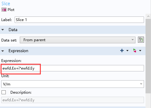

I simulate a meta-surface model when a circular polarized light is normal incident, the polarization state of transmitted light is circular polarized too, and how can I plot the transmitted electric field of circular polarized and light? Could the "expression" in the "plot" be written as "ewfd.Ex+i*ewfd.Ey"?
it could be explained intuitively in attach file.
If you enter a complex expression, then it's the real part that is plotted. What kind of plot are you trying to create?
As you say, I entered a complex expression of incident electric field of circular polarization, which is expressed as E0x=1, E0y=i, E0z=0 in COMSOL, and the polarization state of transmitted electric field is same. I am trying to plot this transmitted electric field with circular polarization state, but I can only find the "expression", such as "ewfd.Ex", "ewfd.Ey" or "ewfd.normE" in COMSOL. Could you do me a favor?
you mean I plotted the real part of electric field of E0x=1, E0y=i, E0z=0?
Yes, I think so.
If I use the options like "ewfd.Ex" and "ewfd.Ey" in COMSOL, that means I plot the X or Y component of electric filed. Now I want plot total electric filed of circular polarized light, what should I do?
