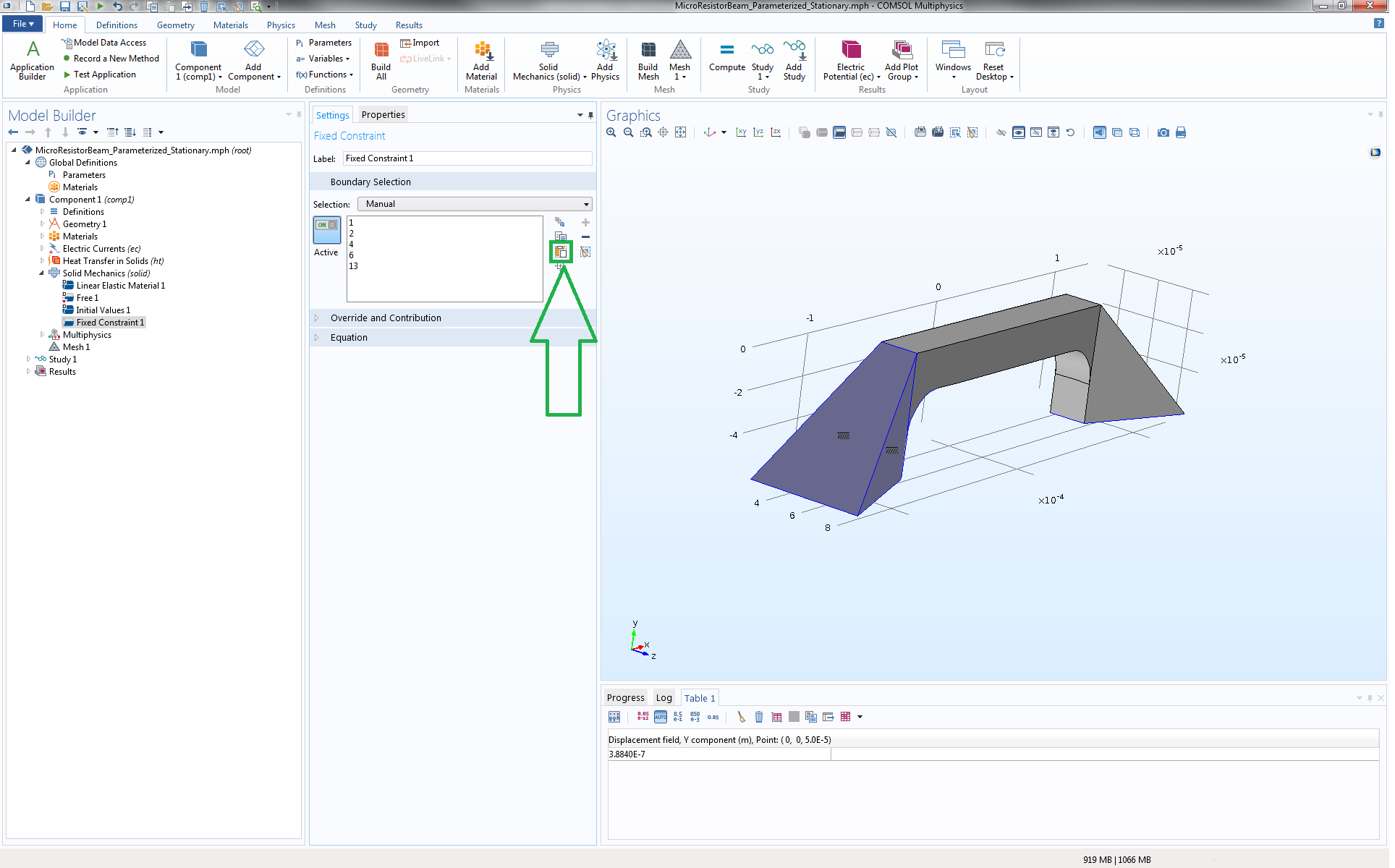

One alternative approach: you can type in the numbers of the points, edges, boundaries, or domains by defining your selection using the "Paste Selection" button (See screenshot attached). In the small Paste Selection window that appears you can use hyphens as a shortcut notation to indicate consecutive numbers. Example: type "7-10 14" to select boundaries 7, 8, 9, 10, and 14.
