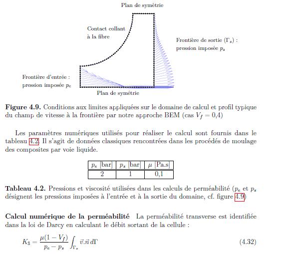

To set up model to calculate the permeability
I want to carry out a simulation with comsol to compare the results of articles and the comsol, the parameters of the model and method of calculation are in the attachment, who can help me solve it, thanks
