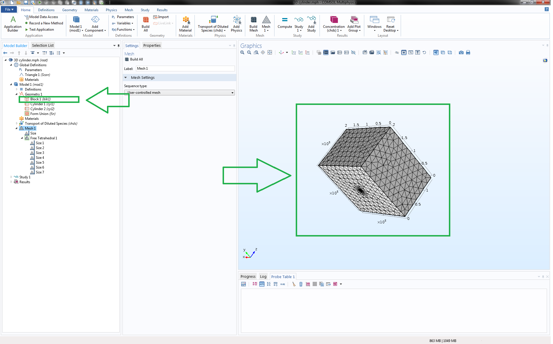

Posted: 10 years ago 1 mars 2016, 13:41 UTC−5
Perhaps you sent the wrong file? Your 3D geometry is not axisymmetric: one part of it is a parallelepiped.
Even if you replaced that block with a cylinder your model would still not be axisymmetric due to the non-axisymmetric boundary conditions.
Perhaps you sent the wrong file? Your 3D geometry is not axisymmetric: one part of it is a parallelepiped. Even if you replaced that block with a cylinder your model would still not be axisymmetric due to the non-axisymmetric boundary conditions. Jeff

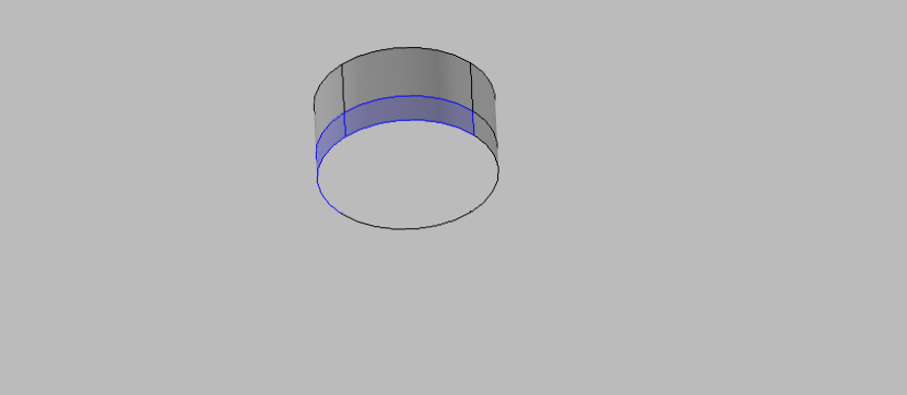

Posted: 10 years ago 1 mars 2016, 14:14 UTC−5
Hi Jeff,
Actually it is a cylindrical geometry. That parallelepiped shape is due to the mesh, since I had to deleted the meshes to send the file. If you please either check the geometry 1 or if you build all meshes you will see the cylindrical geometry.
Hi Jeff, Actually it is a cylindrical geometry. That parallelepiped shape is due to the mesh, since I had to deleted the meshes to send the file. If you please either check the geometry 1 or if you build all meshes you will see the cylindrical geometry. Thanks
Posted: 10 years ago 1 mars 2016, 14:35 UTC−5
See screenshot of your file. Looks like a block to me, regardless of mesh settings :)
See screenshot of your file. Looks like a block to me, regardless of mesh settings :) Jeff

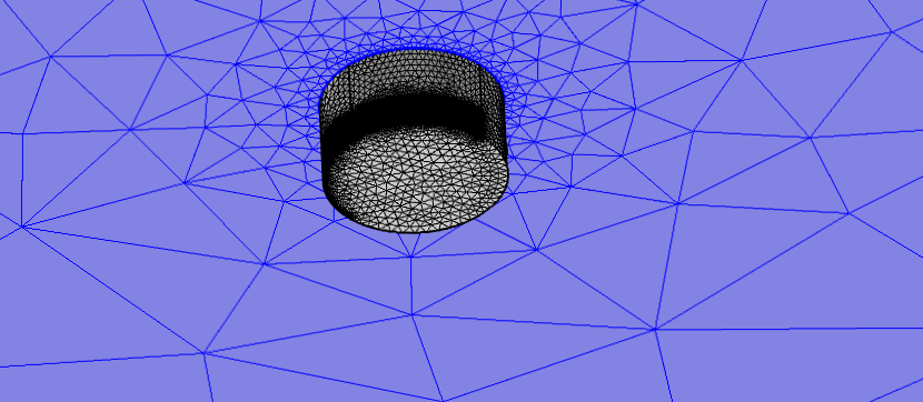

Posted: 10 years ago 1 mars 2016, 15:07 UTC−5
Hi Jeff,
Oh I see, sorry, that block is the domain. Actually I am simulating a recessed cylinder ( r= 250 nm). The whole model consists of: a big block as domain and two recessed cylinder. I am interested in the second cylinder and I solving the problem for half it. Please see the zoom in screenshots.
Hi Jeff, Oh I see, sorry, that block is the domain. Actually I am simulating a recessed cylinder ( r= 250 nm). The whole model consists of: a big block as domain and two recessed cylinder. I am interested in the second cylinder and I solving the problem for half it. Please see the zoom in screenshots. Thanks
