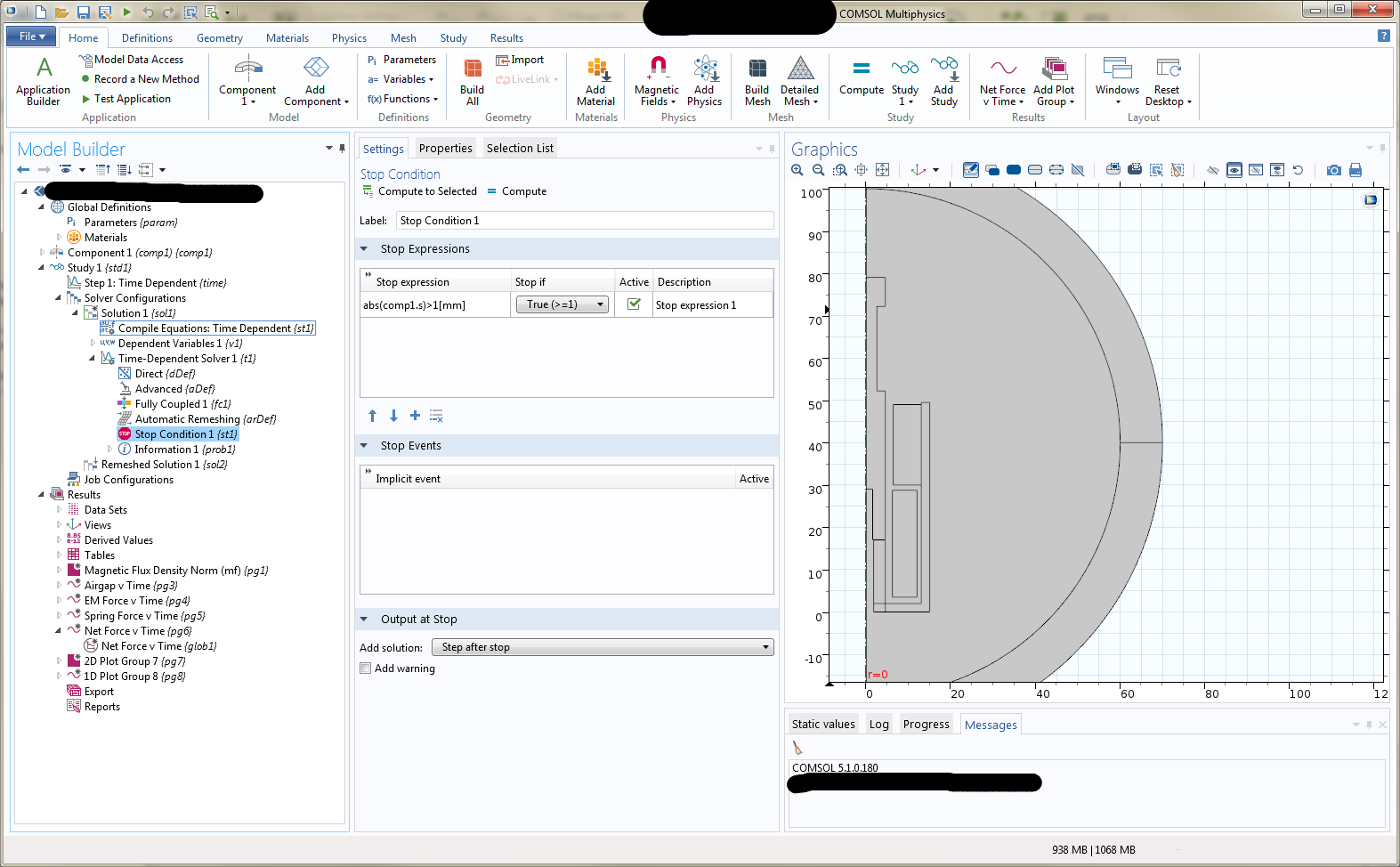

You need to add a stop condition to your solution, so for example if you have a displacement of "s", you will need to add a stop condition for when "s" exceeds a certain value, see attached screenshot.
It sounds like you a re modelling a latching solenoid actuator? I have done some work on these too and used the approach above with success.
Are you looking at the material stresses in your model? You say that you are using the Solid Mechanics interface. If you are not interested in the material stresses, you can remove the Solid Mechanics interface and just solve for the equation of motion, (including gravity, mass and any spring forces within that equation), due to the electromagnetic forces. Let me know if you need help setting this up...
The stop condition can be added by right clicking on your time dependant solver and entering an appropriate terms for the stop condition. In my model, I have set the solution to stop when the magnitude of the plunger displacement is greater than 1mm.

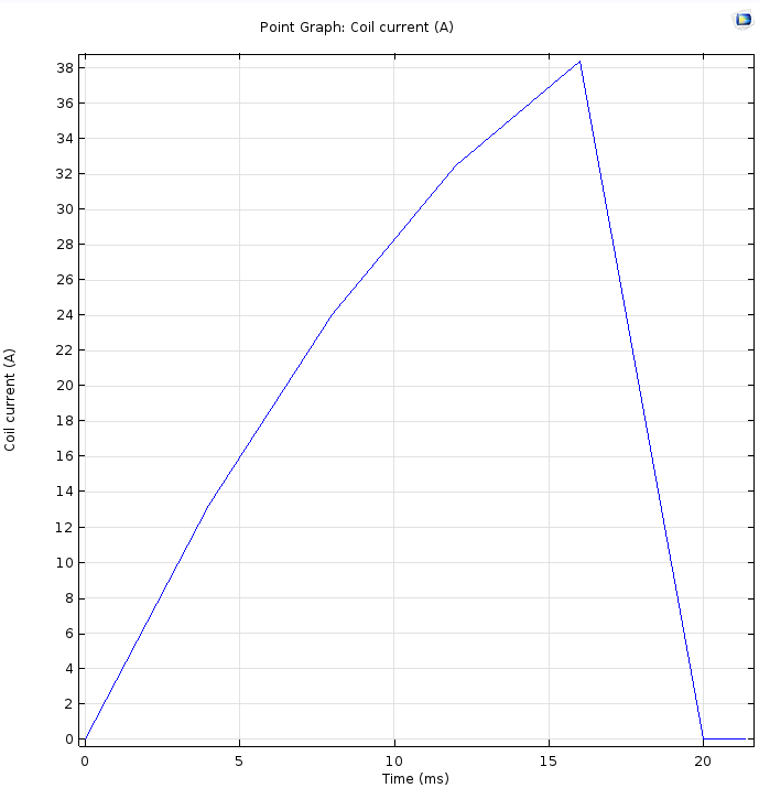

I am energising the coil by applying a current pulse and the calculated coil current is of the shape in the attached screenshot.

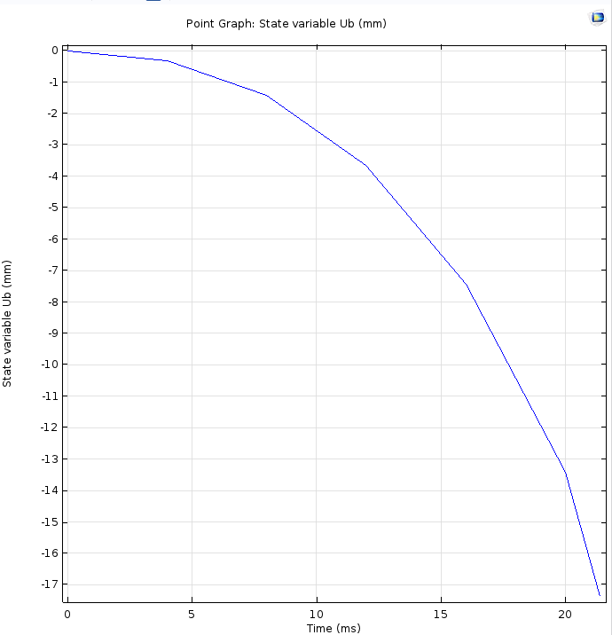

Based on testing in the geometry I am modelling, this current pulse is sufficient to move the armature by 12 mm, so the armature does not reach 17 mm, as it happens in my model. Any ideas?

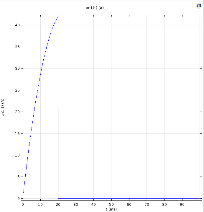

I have attached some screenshots of the current and displacement.

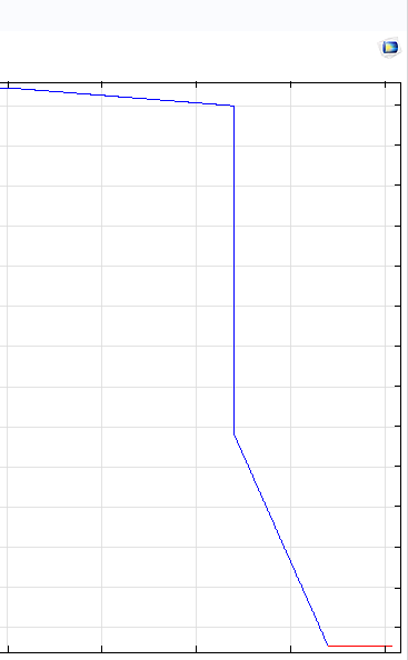

In my case, based on the experimental data, the plunger moves about 8 mm and then it needs other 8+5 mm to latch eventually. So I have defined a piece wise function e.g.
From 0 to 8 (mm) : I have a force which helps the plunger to de - latch from its initial position
From 8 to 13 (mm) : Preload (Constant) + k *(u-8),
where u is the displacement defined as a variable in the global equations.
I attach you a screenshot that may be helpful for you (the y axis is the force and the x axis is the displacement. so at 8 mm, you can see the preload (straight line going down) and after that the spring force is acting.
Pavlos.
