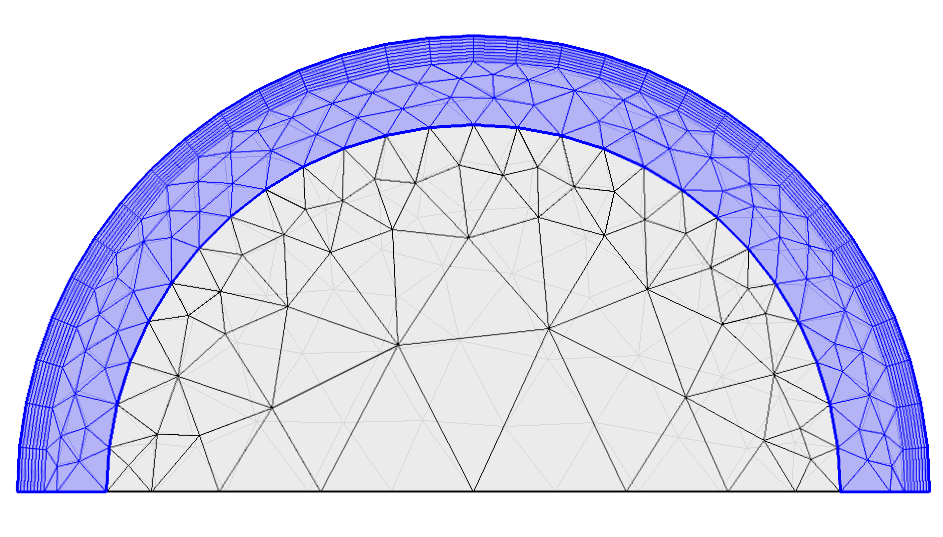

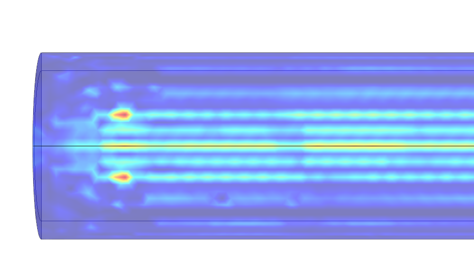

i'm simulating an iron needle in an alternating magnetic field in 3D. Because of the skineffect, i add boundary layers on the surface of the needle, in order to calculate the magnetic flux density on the surface. But the result is wrong, that there are many lines, on which the magnetic flux density is much more higher than other parts.
I have attached the pictures of mesh and result.
