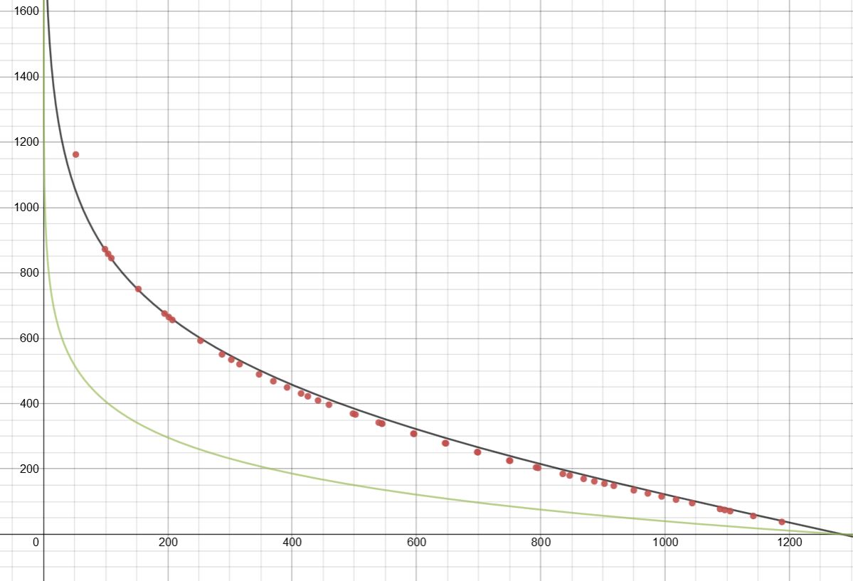

If I scale the analytical function with 1.7, then the curve matches beautifully, see attached picture file
Red dots : simulation result.
Green line: analytical model
Black line: analytical model * 1.7
I manually found out the value 1.7, at this point, I have no idea where this 1.7 is coming from.

the formula gives a potential difference between ri and r. ri has to be >0, so what ri where you using?
In COMSOL the results for r -> 0 will be quite mesh dependent. The line charge creates a singularity at r = 0.

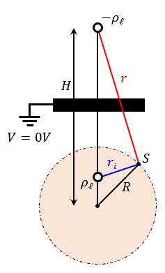

For understanding, I attached a picture.
Please find the attached JPG file
'Vs' is the potential at the equipotential line (which is the cylinder surface)
I set 'ri' as the distance between line charge (rho l)and the cylinder surface,
and 'r' as the distance between the other line charge(-rho l) and the cylinder surface.
both 'r' and 'ri' has no relationship with line geometry itself.
I think if the set up is reasonable, mesh or other comsol simulation set up may has not been properly set.
But the problem is that I can't figure it out at all..
Thanks!
Thanks for the reply! For understanding, I attached a picture. Please find the attached JPG file 'Vs' is the potential at the equipotential line (which is the cylinder surface) I set 'ri' as the distance between line charge (rho l)and the cylinder surface, and 'r' as the distance between the other line charge(-rho l) and the cylinder surface. both 'r' and 'ri' has no relationship with line geometry itself. I think if the set up is reasonable, mesh or other comsol simulation set up may has not been properly set. But the problem is that I can't figure it out at all.. Thanks!
