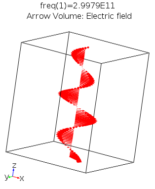

Eugene,
Attached is a model for linearly polarized wave traveling in biaxial media. Wave polarization keeps changing as it propagates, as shown in the attached image. You can still use PML but it requires special scaling.
Sergei
Eugene, Attached is a model for linearly polarized wave traveling in biaxial media. Wave polarization keeps changing as it propagates, as shown in the attached image. You can still use PML but it requires special scaling. Regards, Sergei
