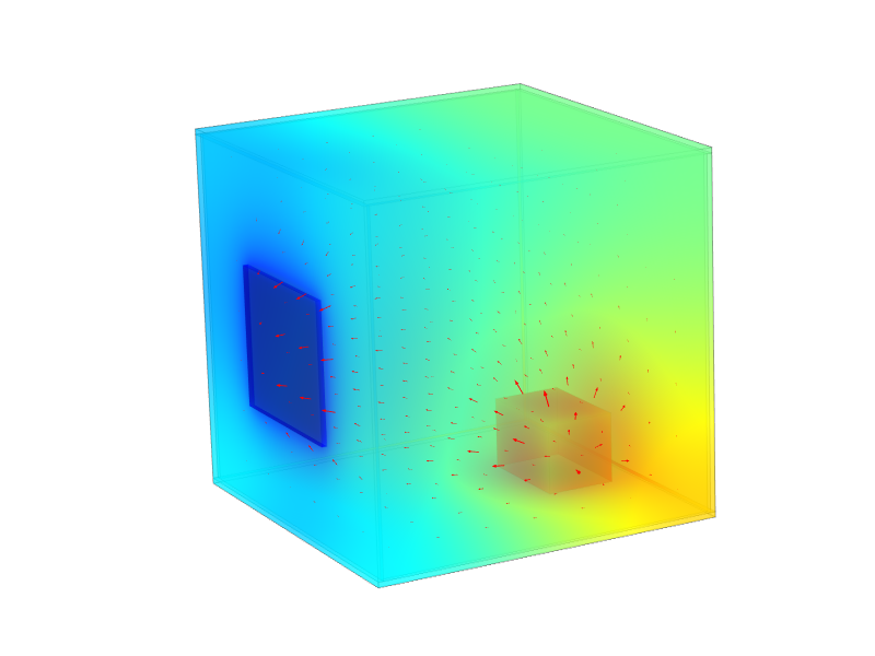

please find inclosed our project.
We created an air cube inside of plywood box
And we are not sure for the periodic boundary conditions for the opening.
We want to see the air movement between the inside room and outdoor through the window.
now, we have not realised the polystyrene insulation. We will add this polystyrene after.

I took a look at your model and did a simple calculation on it, putting a heat source of 100 W/m^3 in the block and a heat flux to the outside through the window at a temperature of 10 degC, with a heat transfer coefficient of 5 W/m*K. I have not taken into account material properties, other effects, etc. You will have to think about that. I'm giving you the model as a starting point, but don't consider it to be holy.
Good luck!
