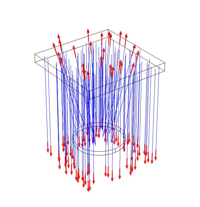

I'm trying to measure the phase of a bundle of rays that are reflected from an aspherical surface.
File 1 attached is the ray tracing and the red plane in file 2 is the surface on which I want to know the phase of the rays.

The 3rd domain is the aspherical surface that reflects the light (the circle in the files attached).

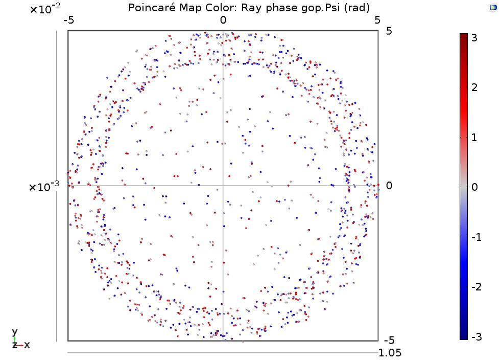

Hi Andrey, the phase is a property of the rays, rather then the geometry, so when you try to evaluate it on a geometric entity, it fails.
The solution is to define a cut plane where you want to evaluate the phase, then use the Poincare Map plot type to create a spot map of the phase. The Poincare Map plot type allows you to plot quantities defined only on the rays at the intersection point between the rays and a geometric entity. You can refer to the attached (V5.2) model to see how to do this.

In my simulation I defined a cut plane and used the "Accumulator" node I understood that I should use to transfer physical information from rays to the domains they pass through. But it didn't work since I do not know how to define it correctly. Can you please help with that method?
I tried the poincare map and it works well when I'm using the color expression and plot gop.Psi, but the results are a little bit weird, I expect a symmetrical phase map and it is not symmetrical (see attached file).
Maybe, has Ivar said, I need a reference ray. How can I define a reference ray that will intersect with the middle of my "cut plane"?

Hi Ivar, you can always use a second release feature which only releases 1 ray, then use the fact that each release feature has a unique index given by the variable gop.prf (Available under the Ray Statistics section of the postprocessing expressions). The ray release variable gop.prf is assigned an integer value, starting at 1. This number corresponds to the order of release features in the Model Builder.
In the attached example, all rays released from "Release from Grid 1" have gop.prf=1. The lone ray released from "Release from Grid 2" has gop.prf=2. Therefore, to plot the difference in phase between the lone ray and the ray bundle, I can use:
gop.Psi-gop.gopop1(if(gop.prf==2,gop.Psi,0))
This is of course on a geometric plane. To do this at a specific point in time, you can use the same expression for the Color Expression in a Ray Trajectories plot.
We are working on making it easier to perform this type of analysis in a future release, including the ability to do it in 2D.
