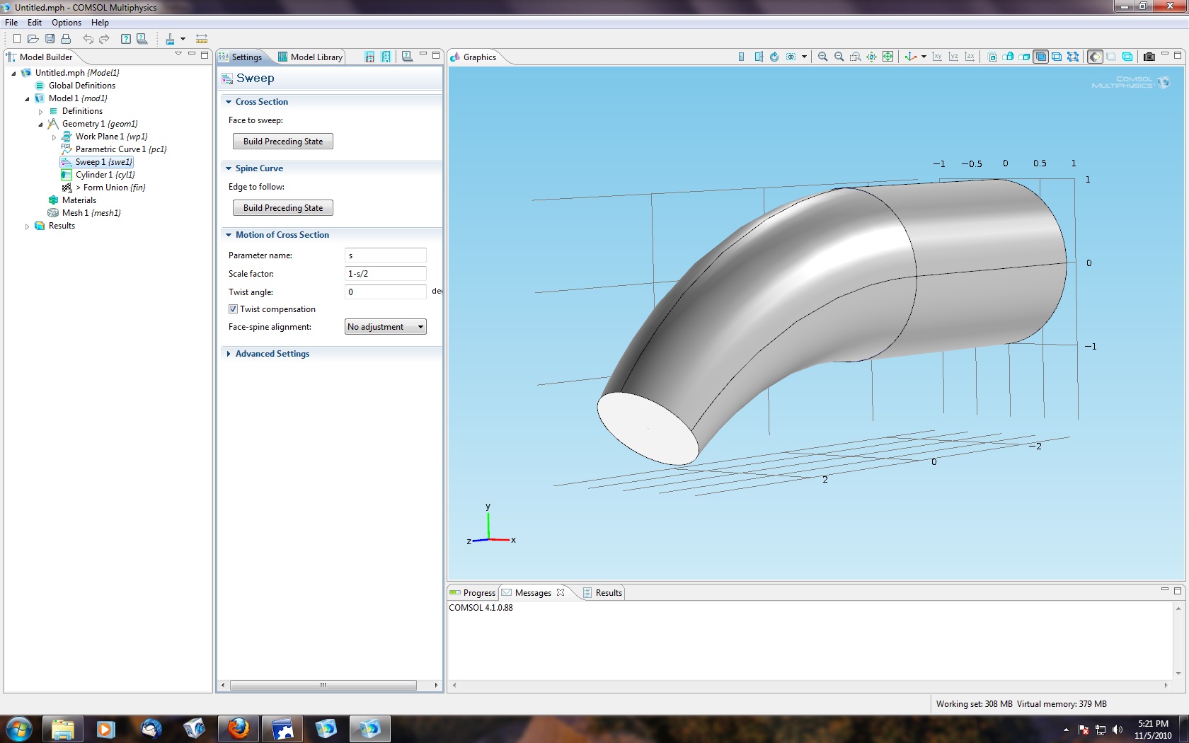

Is it possible to revolve a face and scale (like the scale feature when extruding a face) at the same time? I'm trying to create a smooth transition between two cylinders of different sizes that meat at a 45 degree angle.

It's possible starting at v4.1, see attached screen shot.
It's possible starting at v4.1, see attached screen shot. Jeff
