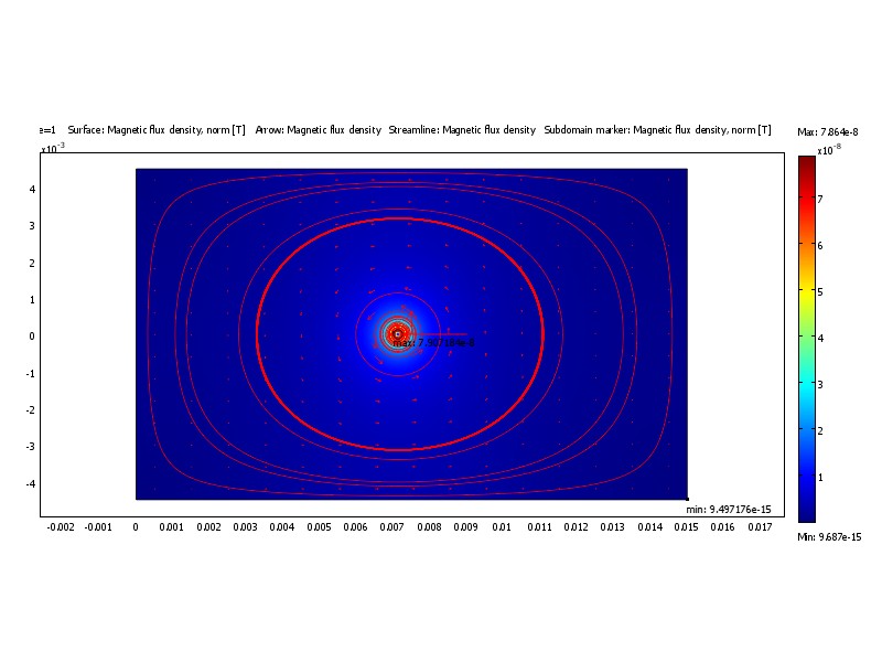

I modeled a circular cross-sectional area wire forming a loop (a coil) carrying current in 2D axisymmetric mode (azimuthal induction current, vector potential). . The model is just a circle which represents the cross-sectional area of the coil wire and this small circle is inside a big rectangle which represents the surroundings.

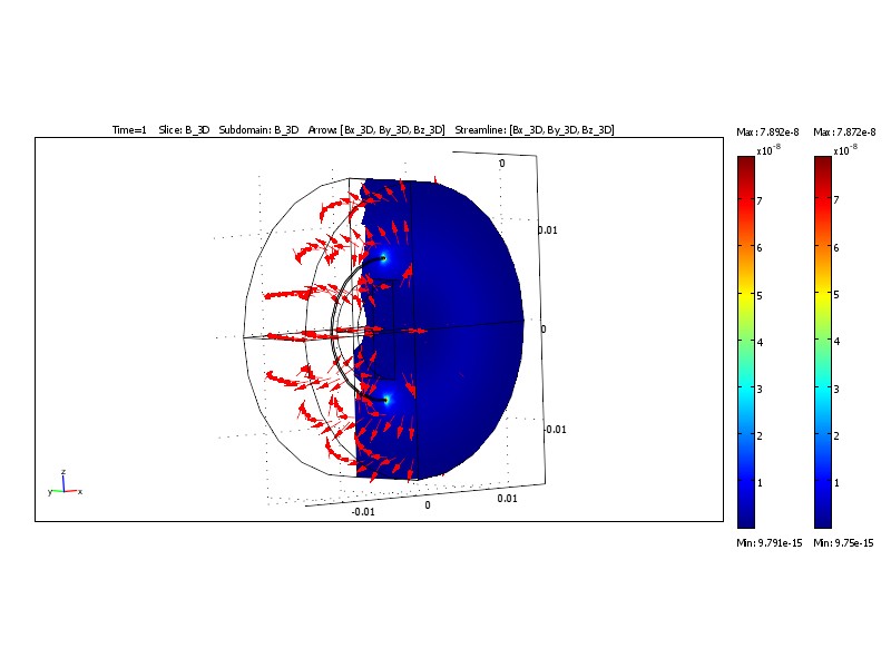

I solved the model and also revolved and mapped the solutions into 3D using extrusion coupling variables

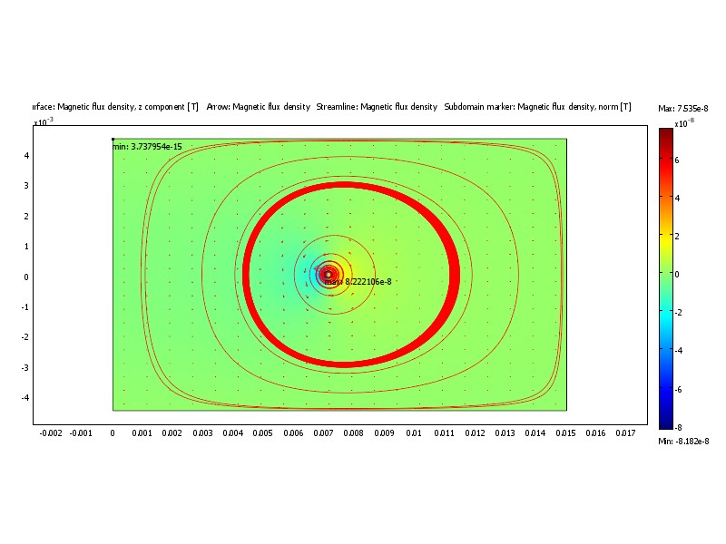

Then I did the same model but instead of starting in 2D axisymmetric mode, I started in just 2D (x,y) coordinates using perpendicular induction currents, vector potential.
In both models, All the geometric parameters are the same, and also the subdomains sub domain settings, but THE VALUES FOR THE FIELD VARIABLE FOR THE SAME COORDINATES, Magnetic Flux Density, B, (BOTH IN THE MODELING PLANE AND ALSO IN 3D) ARE DIFFERENT in both models.

P.S. I am attaching two images of the models for the differences to be shown.

I do not really catch your issue here, in 2D you are claculating a infinitely depth problem expressed as 1/m deep system. in 2D axi you are on a thorus with a loop length (corresponding to the previous depth value) that is 2*pi*r, hence varying.
So for me you should not get the same results, or am I missing a point ?

What I think (of course I maybe wrong) is that after I revolve both planar models I get the same geometry for both: a coil with a circular cross-section (a toroid ) both around the y-Cartesian coordinate. The geometry is exactly the same for both models. See attachments.
Anyway, what I want to do is built the Cartesian Coordinates Model which is equivalent to the model in 2D axisymmetry, and get the same results for both.
Can you give me at least a hint on how to do it (I need a special help about what boundary condition to use in the symmetry axis, I mean the axis I am going to revolve the rectangle (surroundings) and the circle (cross-section of the coil) around to get the 3D model, because that option is not available for boundary conditions in 2D? What should be the equivalent boundary condition in 2D of the "Axisymmetry boundary condition of the r,z axisymmetric mode?

Well my physics understanding tells me that tese cases are not the same, you have a different topology and must adapt the all physics correspondingly, not just a postprocessing loop revolve
What is wrong using 2D axi ? ANd then revolve that ?
