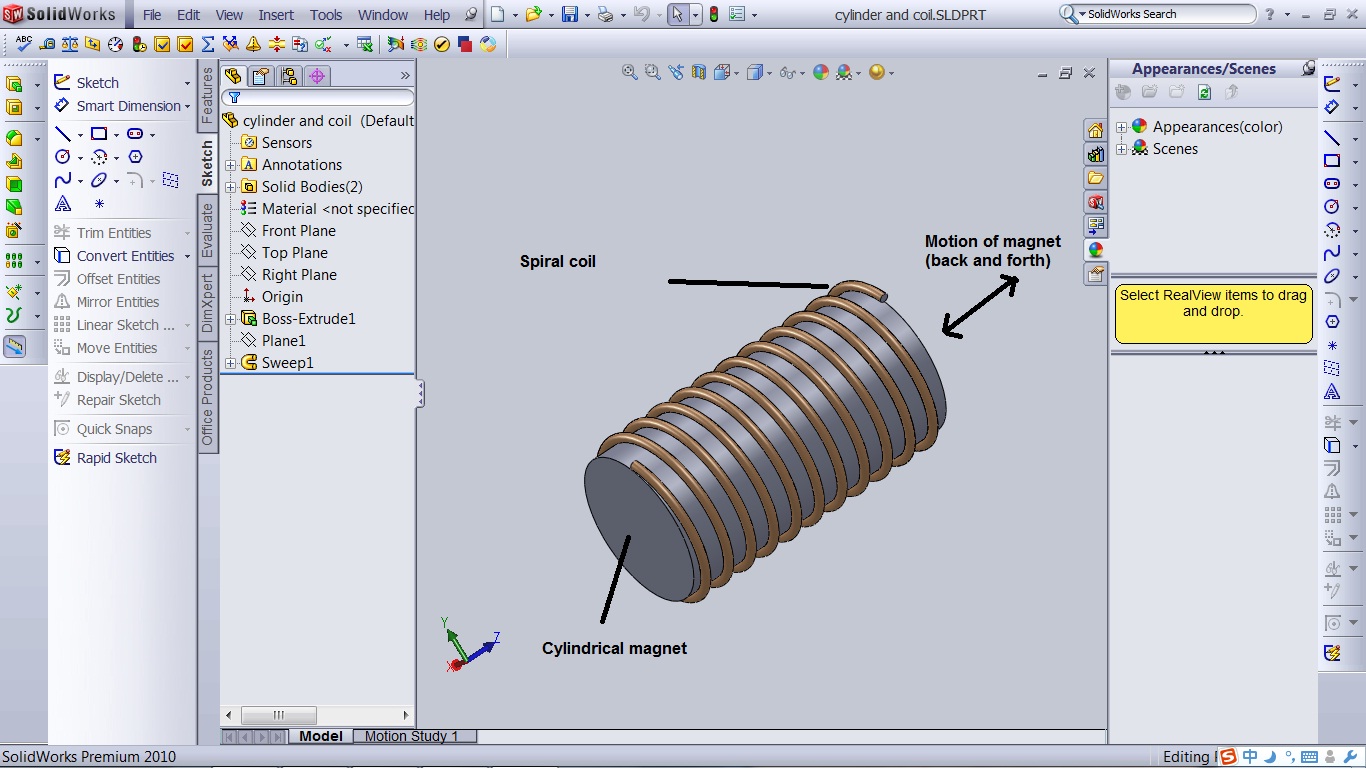

                                                    Hi, I would like to model the Voltage induced in a coil, between its ends,  by moving a permanent magnet back and forth inside the coil.
The User's Guide suggest to solve, when possible, the problem in 2D, but for a spiral coil I think there is no symmetry for the coil (since if I rotate the circles which represent the circular cross-sections of the wire they are going to form straight loops and in the spiral coil the loops are not straight), so maybe I should work in 3D.
Anyway,
1. Which application in ACDC module is more suitable for this model: STATICS MAGNETIC OR QUASI-STATICS MAGNETIC?
2. Can somebody give me advice on how to represent in COMSOL the motion back and forth of the magnet?
Please see the attached file.
Thank you for your help.
