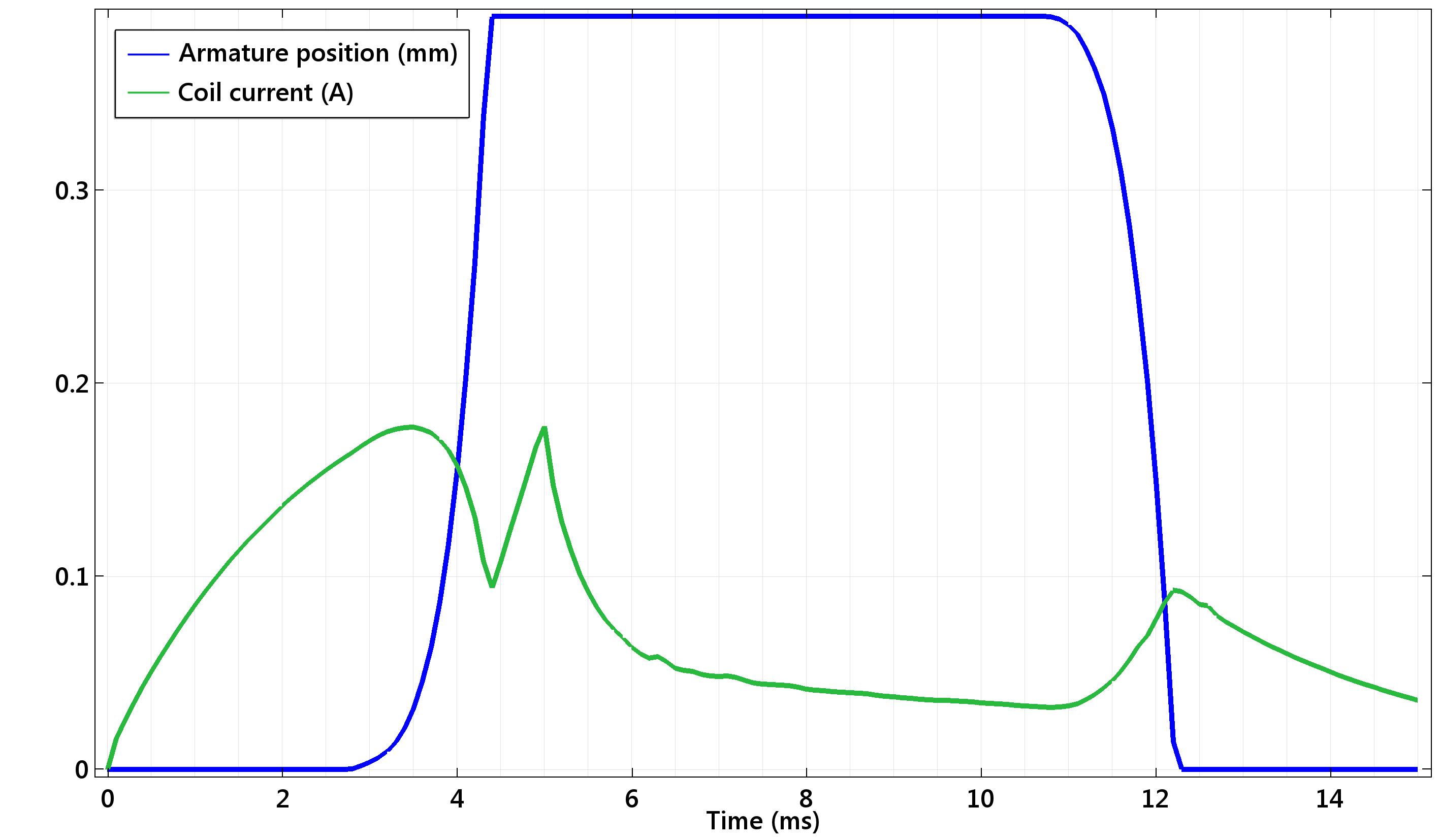

Posted: 9 years ago 13 juin 2016, 08:37 UTC−4
take a lot at this model
Nirmal Paudel COMSOL Employee
Posted: 9 years ago 18 juin 2016, 13:42 UTC−4
Hi Pavlos,
It the motion of the plunger is limited, you could use the approach technique in this blog post.
www.comsol.com/blogs/part-2-model-a-linear-electromagnetic-plunger-with-a-blocker/
This will make sure that your plunger is not interfering with the other parts.
Best Regards,
Nirmal Paudel
Hi Pavlos, It the motion of the plunger is limited, you could use the approach technique in this blog post. https://www.comsol.com/blogs/part-2-model-a-linear-electromagnetic-plunger-with-a-blocker/ This will make sure that your plunger is not interfering with the other parts. Best Regards, Nirmal Paudel
