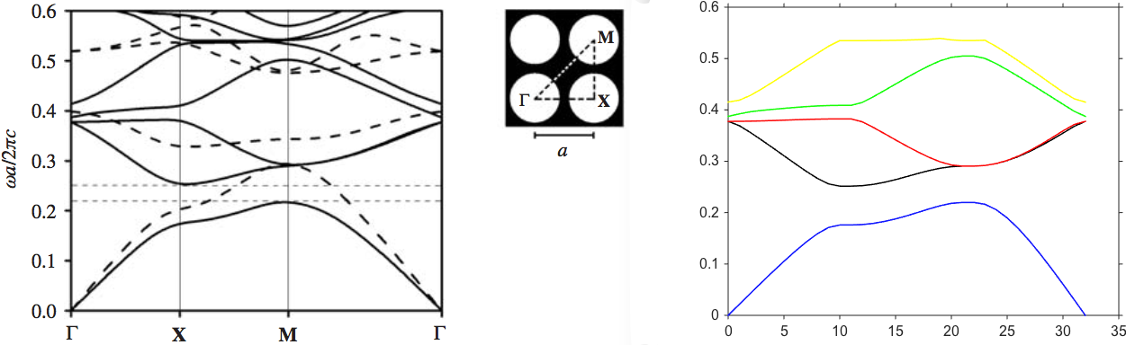

Bandgap of a 2D photonic crystal by COMSOL MATLAB scripting
Posted 5 juil. 2016, 12:10 UTC−4 Wave Optics, LiveLink for MATLAB, API 0 Replies
@book{maldovan2009periodic,
title={Periodic materials and interference lithography: for photonics, phononics and mechanics},
author={Maldovan, Martin and Thomas, Edwin L},
year={2009},
publisher={John Wiley \& Sons}
Attachment 1 is the script, and attachment 2 shows the textbook figure (left) and the figure generated by this script (right) side by side.
Alternatively, see demo and code here: github.com/xiumingzhang/photonic-bandgap-comsol-matlab
